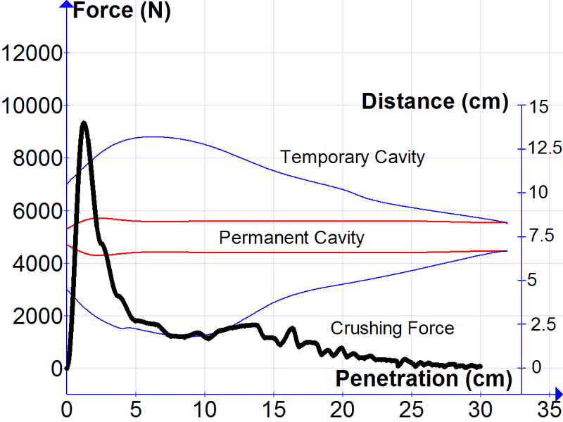

The figure below shows the force stopping a 9mm bullet as it penetrates ballistic gelatin. The stopping distance is about 30 cm. The peak force is about 10,000 N. Of course, the force is greatest right after the bullet impacts and begins to penetrate. Impact energy is close to 600 J.
I like to simplify the physics of stopping bullets into work using the work energy theorem. The average force (in N) times the stopping distance (in m) needs to equal the initial energy of the bullet. If the initial energy is 600 J (typical of pistol bullets) and you can exert a force of 10 N, you need to exert the force for a distance of 60 m to stop the bullet. Exerting a magnetic force over 60 m is hard. Exerting a magnetic force of 10 N on a non-magnetic bullet (copper jacketed lead) is hard. Increasing the force to 600 N to reduce the stopping distance to 1 m is hard. Increasing the distance to 600 m to reduce the force to 1 N is hard.
