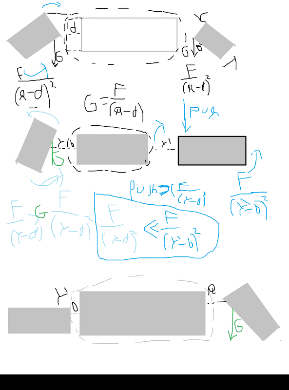

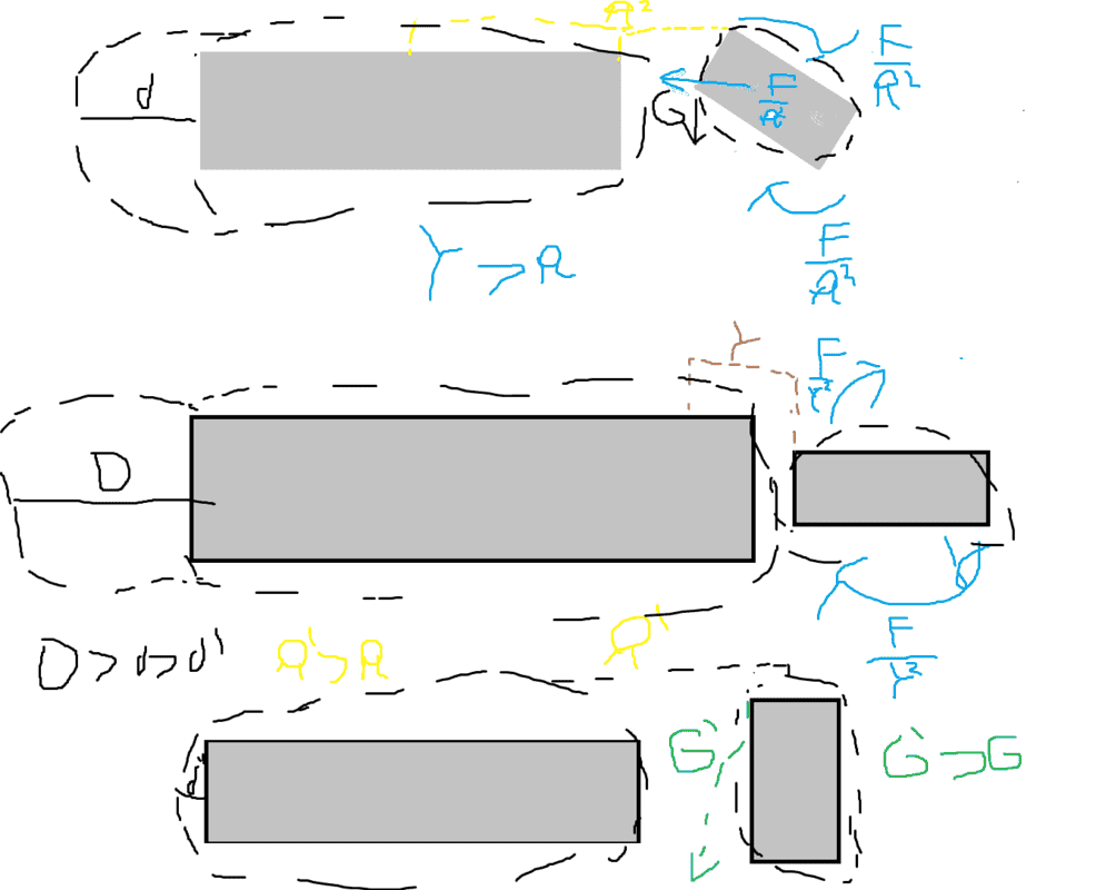

so I made another experience which made it very clear to see(in slow monition) how one magnet movement ,getting longer while the other getting shorter and after while it switch so the the second magnet movement , ,become short again the first magnet movement become bigger it happened three time till the magnet stops .
in the video we can see that after I push the right magnet down it have more energy then the left magnet but then it slowly switch . and then switch again and again
watch till the end in slow monition .
and I draw the magnet force in each position of the magnets. the first draw it the force diagram of two magnet when one is rotating
and the second is diagram of three magnet
this draw can't explain why the magnet power getting stronger and weaker over and over so my guess is that it send some kind of wave that telling the magnet the it angle change and it change from both side so on one side we getting that the power of the magnet is getting stronger and on the other weaker . and then it switch , till it stops because the energy lots . this is actually like beats because it magnets have small difference frequency because they are not in the exacts same distance from the big magnet. so in one magnet when the movement become bigger in other it become weaker because they are in two difference location . and their wave interferer because when one magnet make the middle magnet stronger the other make it weaker .
so thanks everyone I finely understand why it happing I also find it very interesting to try following the forces and it help me understand magnet force a lot it also
It doesn't. The forces between the magnets only change minimally as function of their angle. The exact distance to the central magnet is irrelevant, too - you could use anything else to keep them in a position where small forces can move them.
The small distance-dependent force between the outer two magnets is sufficient to produce the motion your video shows - the motion I derived in post #13. Simple input, somewhat complex result.

danielhaish said:
but if you look at the all video you would se that it change back after servel times
This is normal behavior for coupled oscillators, where one is released in equilibrium and the other displaced from equilibrium. See video at 0.50 min:
ok now i see it
