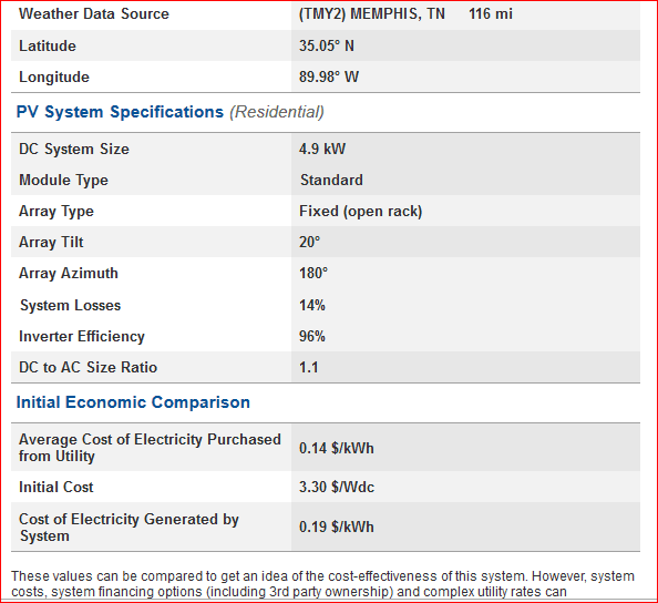

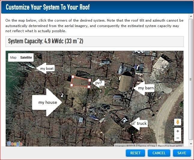

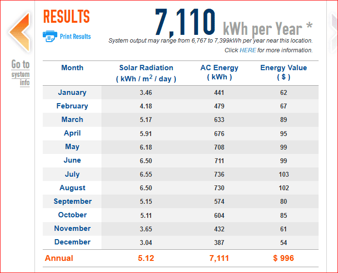

Hmmm stumbled across a nifty NREL site that figures numbers for your address if it's in the US
http://pvwatts.nrel.gov/pvwatts.php
here's what it says for a hypothetical 4kw system for my houseit's a cool site !
View attachment 100117View attachment 100120View attachment 100109If i converted clothes dryer and water heater to propane i might break even in non airconditioning months. My winter heat is a wood burning fireplace plus a small propane gas heater .
Even at $2.50 a watt it'd be a $10,000 investment
to unplug from grid i'd have to add BIG batteries , and maintain them
and give up airconditioning or use the little diesel generator i keep for emergency backup (and wear it out...)
Myself i think i'd rather collect solar to heat water directly , eliminating that 3.5kw load
and have a couple hundred watt panel & battery for 12V DC lights and a TV when power is off
use the diesel generator's starting battery...that way it'll stay charged...
Rooftop solar looks to me affordable for DIY'ers. As OM points out , the parts are getting cheaper. (Google returns panels for $1 a watt.)
But it doesn't replace the grid or central station generators. Yet.
Electric company still enjoys economy of scale and delivers energy dirt cheap.
I cut firewood mostly to retain some semblance of physical strength . You swing an 8 lb splitting maul for an hour and you too will appreciate that steam turbine somewhere out there, sending you hot water by wire.
old jim
Jim, your reference price includes installation, inverters, the works. I don't think $1 per W includes installation.

OmCheeto said:
The winter months though, is why I really appreciated your link.
I think the calculator let's you adjust tilt of the panels. it set mine at 20 degrees,
I don't know whether that's off vertical or off horizontal...
and whether it's a simple default or some function of the local 35° latitude it used for local irradiance.
Might you try tilting for perpendicular to sun around winter solstice and see if winter output gets any better ?
Optimize for winter , accept a little less in summer when you don't need it ?
