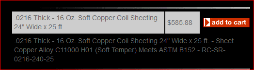

U of Florida did research on thermal collectors forty-five years ago
and concluded a DIY'ers can't beat flat plate collector with intimate contact between plate and tubes.
They used copper sheet with copper pipes soldered to it on 12" centers
because the average home handyman can solder copper but he can't weld aluminum.
4 X 12 feet makes plenty of hot water for a family of four in Florida.
Does it ever freeze where you live?

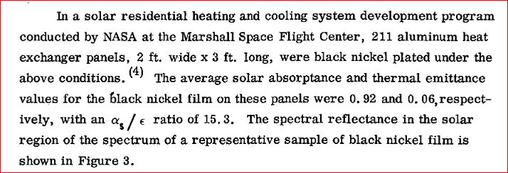

...unless you electroplate the whole collector with blackened nickel and that's another story...
http://ntrs.nasa.gov/archive/nasa/casi.ntrs.nasa.gov/19770013623.pdf
old jim

Nickel plating! Perhaps you aren't aware of my budget for these types of experiments.
