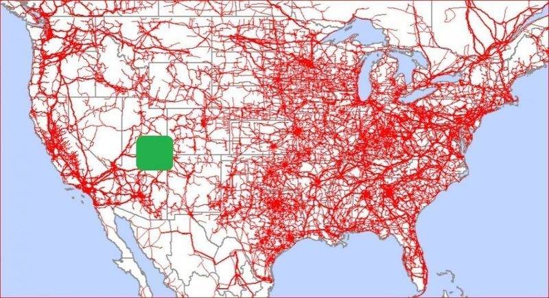

jim mcnamara said:
2. It would take trillions to upgrade the electric grid. My 2005 WECC map show Texas with 2 tie lines, good luck pushing 80000MW through them
(With today's security environment good luck finding detailed transmission line maps...)
Generation is presently scattered and near point of use so most transmission lines aren't very long.
Take this map and redraw it for all generation emanating from the region of green rectangle.
It goes from a structure supported by a foundation underlying pretty much all of itself to one that's suspended by long spindly arms.
And for right now that's more than enough for me to contemplate. Old guys just don't handle fundamental change all that well.
old jim
credit for that map goes to
http://docplayer.net/docview/25/5923397/#file=/storage/25/5923397/5923397.pdf
with a big "Thank You ! ".

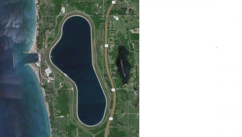

Perhaps batteries wouldn't be the best energy storage device. I visited a power plant south of Luddington Michigan which pumped water from Lake Michigan to a large reservoir at night when electric rates were low and let it flow back through a generator during the day when the rates were high. Some of the energy was stored in a large flywheel. One advantage of a flywheel is that there are lower losses converting between DC and AC. Energy from DC solar panels can be added to the flywheel with a DC motor and extracted using an alternator to feed the grid.

skeptic2 said:
...visited a power plant south of Luddington Michigan which pumped water from Lake Michigan to a large reservoir at night when electric rates were low and let it flow back through a generator during the day when the rates were high. ...
While the pumped storage hydro capacity in the US is useful for leveling a bit of peak demand, it's a trivial amount compared to the hundreds of TWH required to backup up the entire US for several days, the topic of the OP. The typical run time for a PHS plant is a few hours.

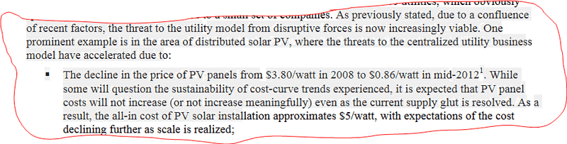

anorlunda said:
However as Jim pointed out in #3, the cost of panels is only $0.86 out of a total installed cost of $5/kw.
Obviously, you meant per watt.
Yes, sorry. $0.86/watt for the panel, and $5/watt "all in ncost" In addition, I should have said that most of the $5.00-$0.86=$4.14 difference is not much dependent on the ##m^2## of the panels.
