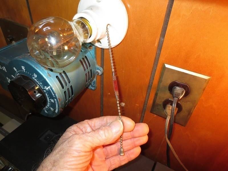

TurtleMeister said:
Due to a defect in the lamp the chain was shorted to the 120v hot wire.
The "old timers" realized this possible problem. :approve:
Very nice solution. I've never seen that before.
