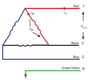

Well, as I have said in various posts, Norway's traditional power distribution does not include "neutral". It is a "delta" distribution:
The "ground" is not a part of the distribution, it is named "protective ground" and it is connected to "earth" at the base of the house. This ground is theoretically at the center of the delta, but in practice it may be quite off center electrically. Anyhow, it is quite possible to draw some small current between either phase and "protective ground". And, since no phase is more "neutral" than others, all wires are "live" (that is why double pole light switches are mandatory in "wet" rooms and outside lights).
Ah, I didn’t know that. But how is the protective ground part of the circuit? The three phases off the delta look like they are not referenced to it. How does a fault current get back to the supply?
Through the earth. But due to the geology in Norway the "earth" does not conduct very well, so even a small ground current can create a large voltage drop between the supplier and the ground fault.
