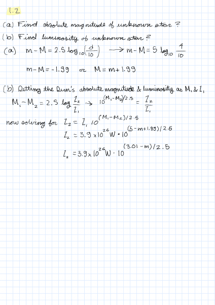

Textbook problem 1.2: A star at a distance of 4 pc has an apparent magnitude 2. What is its absolute magnitude? Given the Sun has a luminosity 3.9 x 10^26 W and an absolute magnitude of about 5, find the luminosity of the star.
[/B]
m1-m2[/SB]=2.5log(ι2/ι1)
m-M=2.5log (d/10)2
3. The Attempt at a Solution
Handwritten physics working on graph paper: part (a) finds the absolute magnitude M of an unknown star from m - M = 2.5 log10(d/10), giving M = m + 1.99; part (b) solves for luminosity L2 = 3.9 x 10^26 W x 10^((3.01 - m)/2.5).
Not sure if my approach and answers are correct
Please help

First question: In your very first line with an equation, you changed the factor of 2.5 to a factor of 5 in front of the log. Why did you do this? This seems to be a mistake.

I forgot the exponential: m-M=2.5log(d/10)2

AH yes, Ok.
EDIT: you seem to have made a sign mistake. In the exponential for the calculation of the luminosity, you should have
M_1 - M_2 = M_1 - ( m +1.99) = 5 -m - 1.99
Then your work looks good. You just need to plug in the value of m=2. The absolute magnitude of the star is smaller than the Sun's absolute magnitude (3.99 versus 5) so the star has a larger luminosity than the Sun's and your final expression agrees with this. All the steps look good.

Thanks a bunch and sorry for the typo
