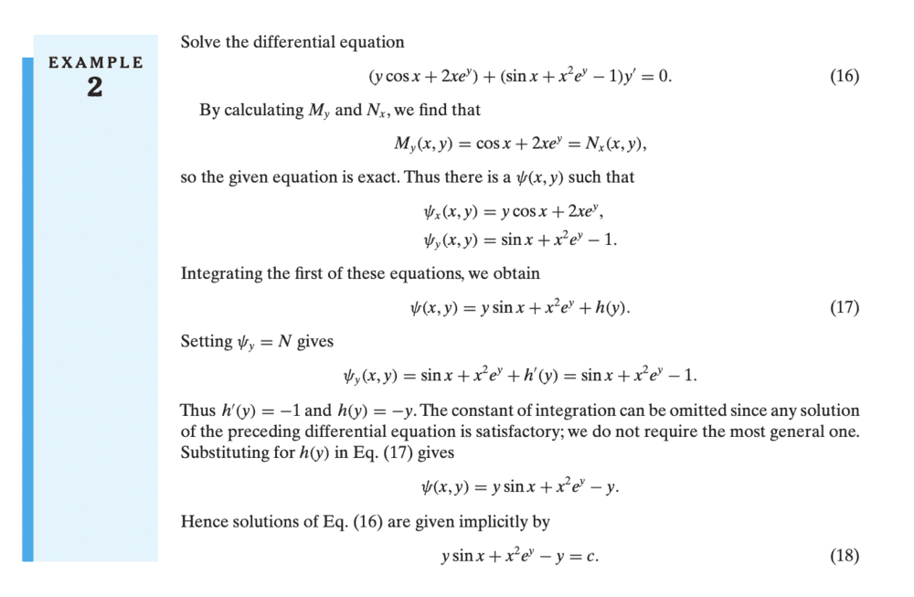

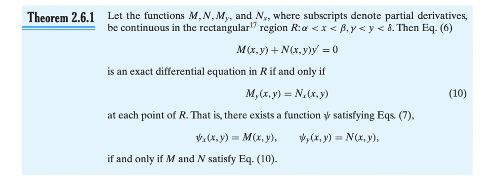

This is a class of ODE known as exact equations in this text
Here is the theorem that gives the solution and a corresponding example from the text
once you get the hang of the process it becomes pretty simple actually.
Here is the theorem that gives the solution and a corresponding example from the textView attachment 281782
