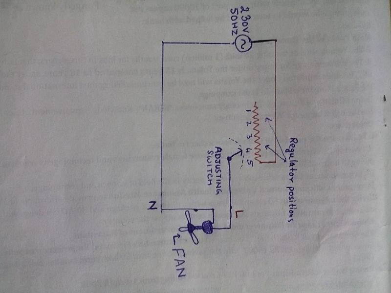

actually i searched a lot regarding this question but didnt find exact answer anywhere.some say electricity bill reduces some vice versa.do all extra voltage is dissipated as heat? in the regulator,or current drawn remains same or only partially dissipated as heat.Thanks.

http://maxelectrical.tradeindia.com/fan-regulator-1133953.html a fan regulator is a device put in series with fan to alter its speed.it can provide different value of resistance through a rotatory switch numbered 1 ,2,3,4,5.At position 5 the speed of fan is max.at 1 its min.as resistance of regulator is max.at that position.http://maxelectrical.tradeindia.com/fan-regulator-1133953.html

it has been designed for India 230v/50hz.it gets hotter if we increse its resistance through rotary switch(to position4,3,2,1),but the fan slows down.as it gets reduced voltage now.sorry if i am still not able to elaborate.
The current drawn from the mains will reduce as you slow the fan with a series resistor, so the power bill will reduce. You are paying some for the heat generated by the resistor, but overall you save money since the watt-hours that you are billed for is current* 230V* time.

http://maxelectrical.tradeindia.com/fan-regulator-1133953.html a fan regulator is a device put in series with fan to alter its speed.it can provide different value of resistance through a rotatory switch numbered 1 ,2,3,4,5.At position 5 the speed of fan is max.at 1 its min.as resistance of regulator is max.at that position.[PLAIN]http://maxelectrical.tradeindia.com/fan-regulator-1133953.html[/QUOTE]
This is unlikely to insert varying resistances in series with the fan. This probably electronically switches just a portion of each AC cycle through the fan, thus reducing the average voltage and hence reducing the fan's speed. The part of the voltage that isn't used by the fan represents saved power, rather than wasted power (generating heat) that you would see with added resistance.
The device in post #6 is most likely an inductor with variable taps. Last ones I installed for ceiling fans used this approach and looked very similar to what was posted.
