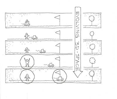

It might help to understand that there are at least two views of the universe:
1) The physical universe is 3-dimensional, evolving in time. The special features such as constant speed of light for all observers (regardless of relative velocities among them), relativity of simultaneity, time dilation, length contraction are best understood mathematically (Minkowski metric and Lorentz transformations, etc.).
2) The physical universe is 4-dimensional (the "block universe"--it's all there at once) and different observers moving relative to each other have different instantaneous 3-D cross-section views of the 4-D universe (after you've accounted for light travel time delays).
The more I read this forum, the more I get confused. Am I correct you propose two different theories of Special Relativity? Never heard of this.
Do you mean an evolving 3D space (invariant, one and the same for all observers) can contain non-simultaneous events? That's new to me. I always thought 3D space = simultaneous events. If relative moving travelers consider a different set of events to be simultaneous, then obviously they consider different 3D spaces.
What else is 3D space 'made of' if it is not simultaneous events?
If for the car driver the event "hitchhicker with hands up in the air" is simultaneous with event "car at flag pole", then obviously the car's 3D space environment can not be any of the indicated horizontal 3D spaces.
If simultaneity is not related to 3D space, then what is 3D space?
The more I think about all this I slide into semantics and the more obscure it gets. Is it wrong to state that the simultaneous events part of 3D space 'exist'?
If not, then what are events? If I observe an event (or rather: observe the image of an event), then that event 'existed' spatially separated from me before the lightbeams from that event reach me. Or what else is observation?
I also am of the opinion that a distance between simultaneous events means spatial separation between the events. Mathematics measures something that's out there to be measured. If the car driver 'measures' a spatial distance between his car and the event 'hitchhiker hands up in the air', then the events 'car at flagpole' and 'hitchhiker with hands in the air' have to be there (exist), and they are 'space related', i.o.w events of 3D space.
In your (one for all observers) evolving 3D space scenario where the above two events are not part of (a) 3D space, the simultanity of above two events can only be a fictitious mathematical result of calculation. Is this part of Special Relativity physics?
I guess you refer to an old ether theory before Einstein's relativity in which the primed space and time coordinates of the Lorentz Transformations were indeed only fictitious data (Lorentz called them "auxiliary mathematical quantity"). Lorentz later admitted this shortcoming as a failure.
Only Einstein's 4D spacetime with different 3D spaces for relative moving travelers can give physical transformations to equally valid frames. Nothing fictitious.
In 4D spacetime all events are a given, as one lot, one entity. For Newton and Lorentz the 3D space was invariant, but in Special Relativity the invariant is 4D spacetime, in which 3D space is only relative: relative moving travelers through (in) 4D spacetime consider different set of events to be simultaneous, i.e. different 3D spaces.
I do not see how 4D spacetime can be compatible with a (for all observers invariant) evolving 3D space. And reading Einstein's words (see above) I am not (yet?) the one to contradict him.
There's only one Theory of Special Relativity but many compatible interpretations.

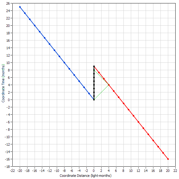

I just made some spacetime diagrams for another thread but they also work for your scenario. Here's one for the IRF in which the hitchhiker and the flag are at rest. The hitchhiker is depicted in blue and the flag is in red. The car is in black and is traveling at 0.8c from the hitchiker to the flag. The dots show each observer's/object's Proper Time of one-month intervals. (Ignore the green lines.)
Now we could say that the event of the hitchhiker throwing up his hands occurs at the Coordinate Time of 10 months (which is also the Proper Times for the hitchhiker and the flag because they are not moving) and for the Proper Time for the car of 6 months. It's clock is Time Dilated because it is moving in this IRF.
Now we can show the same information in the rest frame of the car:
Now if you look at the Proper Time of 6 months for the car (which is now also the Coordinate Time since the car is stationary), it is no longer simultaneous with the Proper Times of 10 months for the event of the hitchhiker throwing up his hands and the Proper Time of 10 months for the flag. In fact, the first happens way later and the second happened way earlier.

Now you're talking about something else. If you want to depict how observers actually see events, you need to draw lines at 45-degree from the event to the observer. For example, you can see in the above diagrams how the flag sees the event of the car leaving the hitchhiker as the first green line. The line starts at the event (Coordinate Time and Distance both equal zero) of the car leaving the hitchhiker and arrives at the flag at its Proper Time of 12 months. This is the same in both IRF's. You can pick out any other event and its observation by any observer and it will be the same in either IRF. Unfortunately, there are not too many such examples that you can show on those diagrams but you can print them out and extend them to include more examples.
I don't see what is confusing about this. It's very simple and easy to understand.
