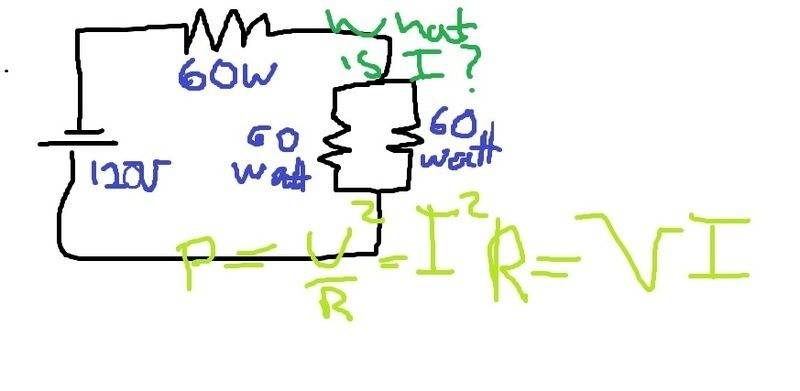

What is the current leaving the cell.
Since all the resistors have the same drop in watts, I assumed both "sections" will lose drop 6V. So each side of the the parallel section drops 6V and the single resistor also drops 6V.
Then I tried to find the resistance in ohms of each one. P=V^2/R... 60^2/60=60.
So I assumed every resistor is 60ohms. I then went to find the total resistance of the system (60^-1+60^-1)^-1+60. Rt=90.. Then I used V=IR 120/90 to find current. I end up getting 1.3Amps is this correct ?

I don't get 1.3 amps.

Thats what I did with the P=V^2/R I found the resistance of each resistor. Then when I found the resistance was 60, I did the total resistance of the circuit. For the parallel part I did (60^-1=60^-1)^-1 = 30 resistance there, and for the series I just added 60. The total resistance of the circut is 90 no ?
I assumed each section of the circuit dropped 60 of the 120 volts because they are = in power drops. So wouldn't the top series resistor drop 60 volts, and the parallel resistors as a whole drop 60 volts?
The resistance is not 60 ohms for the resistors.
It's no help having someone tell you your answer is wrong, some guidance would be kindly accepted.

Please give the complete statement of the problem as it was given to you.
Let the resistors have resistances R1, R2, and R3. As you had written, the current and voltage drop across a resistor is:
[tex] I = \sqrt{\frac{P}{R}}, \ V = \sqrt{P \, R}[/tex]
Resistors 2 and 3 are connected in parallel, therefore the voltage drop across them is the same.
[tex] V_2 = \sqrt{P \, R_2} = V_3 = \sqrt{P \, R_3} \Rightarrow R_2 = R_3[/tex]
This means that the current passing through each of them is the same.
According to 1st Kirchhoff rule, the current through resistor 1, is twice as big. But, the power delivered is the same. Therefore:
[tex] I_1 = 2 I_2, \ P = I^{2}_{1} \, R_1 = I^{2}_{2} \, R_2 \Rightarrow 4 R_1 = R_2[/tex]
We have found the relative resistances of the three resistors.
What is the equivalent resistance of the three resistors in terms of R1?
What is the current flowing through resistor 1, in terms of V = 120 V, and R1?
What is the power delivered on resistor 1, in terms of V, and R1? You know that this power is 60 W. Find R1 from here.
Go one step backwards and find the current through resistor 1. This is the same current flowing out of the source.

The graphic doesn't strike me as a typical homework problem.
The job of the cell is to supply the power.
The total output of the cell must be equal to total output of the load.
For house electric consumption, you're charged by the amount of load total wattage irrespective how you connect your appliances, series or parallel.
Azizlwl has right, concentrate to the power data. The power supplied by the source equals to the sum of power dissipated on the resistors.
And you know how the power supplied by the battery is related to the voltage and the current of the battery.
You do not need the resistance values.
ehild

In my opinion, this problem is in need of a precise statement.
While it makes sense to assume that the problem is giving the power being dissipated by each resistor, it's also reasonable to assume that the problem is giving the power rating of some ohmic devices, where the power rating is for some standard voltage, such as 120 V.
Assuming that we are given the power actually dissipated by the resistors in this circuit, I get that the current through the power source is 0.15 A . Looking at that answer, I see a quicker way to get it than what I went through. Asking, "What is the total power delivered by the 120V source?", gets the answer immediately. Of course, that's probably the method that OmCheeto used when working the problem in his head.
