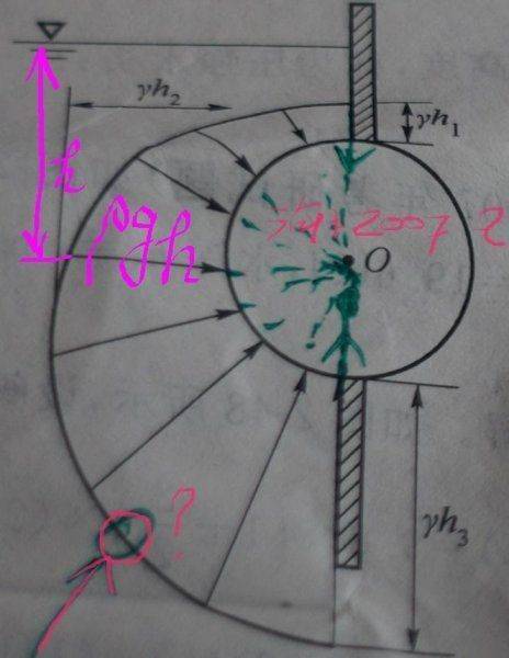

dodonaomik
The problem: the distribution of pressure of the left side of the circular cylinder
ρ= the density of water
γ=ρg
P=ρgh
circle O = a long wooden circular cylinder

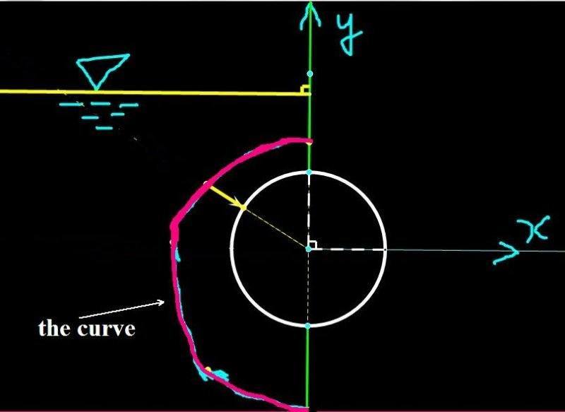

MY QUESTION:
Please see the curve indicated by the green/purple circle in the above picture.
Is the curve a spiral? And what spiral?
[/B]
A sketch map

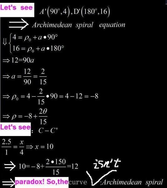

I was ever sure the curve isn't an Archimedean spiral by calculation and verification.
Please see the following 2 figures.
(Of course, I may be wrong!)
