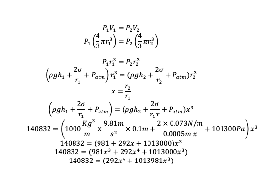

Actually, as the radius of the bubble increases, the contribution of surface tension to the pressure of the gas inside the bubble decreases. And you have already shown that for the depth of 4 m, the surface tension contribution to the pressure is only 292 Pa out of 140832 Pa, or much less than 1%. You will find that the surface tension contribution at the shallower depth will be even less. So, you might as well neglect surface tension. But it's very minor effect can still be included if you really want to.
I will probably include it, but how I will be able to calculate the radius at 0.1 m?
You have a non-linear algebraic equation to solve, right? What methods do you know of for solving a non-linear algebraic equation?
Let me summarize what you have so far: $$P_1\left(\frac{4}{3}\pi r_1^3\right)=P_2\left(\frac{4}{3}\pi r_2^3\right)$$ or, equivalently $$P_1r_1^3=P_2r_2^3$$with $$P_1=P_{atm}+\rho g h_1+\frac{2\sigma}{r_1}$$and$$P_2=P_{atm}+\rho g h_2+\frac{2\sigma}{r_2}$$Combining these equations gives:
$$(P_{atm}+\rho g h_1+\frac{2\sigma}{r_1})r_1^3=(P_{atm}+\rho g h_2+\frac{2\sigma}{r_2})r_2^3$$Next, defining $$x=\frac{r_2}{r_1}$$ we have:$$(P_{atm}+\rho g h_1+\frac{2\sigma}{r_1})=(P_{atm}+\rho g h_2+\frac{2\sigma}{r_1x})x^3$$Our objective is to solve for x. Do you agree with this so far?
It is possible to solve this cubic equation in x analytically, but it is much easier to solve numerically. Any ideas on how to solve it numerically? Have you heard of the "method of successive substitutions?" What level of math have you had so far in your courses?
I have stopped uni 3 years ago, don't remember much but trying my best. is it fine like this
Handwritten-style typeset derivation: P1V1 = P2V2 and P1(4/3 pi r1^3) = P2(4/3 pi r2^3), reduced to P1 r1^3 = P2 r2^3, substituting pressure terms, then x = r2/r1 and 140832 = (1000 Kg/m x 9.81 m/s^2 x 0.1 m + 2 x 0.073 N/m / (0.0005 m x) + 101300 Pa) x^3, simplified to 140832 = (292x^4 + 1013981x^3).
