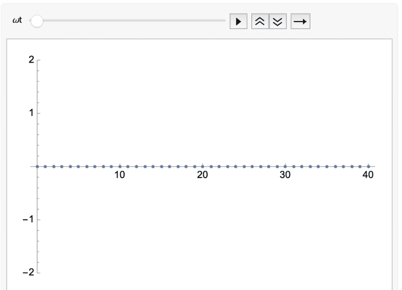

A picture with math is worth 103 words.
Below is shown a collection of 41 independent vertical spring-mass systems oscillating up and down with no energy losses. Each of the masses, differs from its two neighbors by a constant phase.
1. Traveling Wave
##y(x,t)=\sin(kx-\omega t).##
If you concentrate on a single dot, you will see it execute harmonic motion; if you concentrate on a peak or valley (constant phase), you will see it move (displaced) to the right. All point masses have the same amplitude of 1.
2. Standing Wave or Two Waves traveling in opposite directions
##y(x,t)=\sin(kx-\omega t)+\sin(kx+\omega t).##
There is no displacement of constant phase. The point masses have position-dependent amplitudes varying from 2 to zero.
3. Two traveling waves close to destructive interference (in one dimension)
##y(x,t)=\sin(kx-\omega t)+\sin(kx-\omega t+\frac{15\pi}{16})##
This is a traveling wave with reduced amplitude and different initial value from the one above. All point masses have the same amplitude of about 0.2
4. Two traveling waves exactly at destructive interference (in one dimension)
When the phase difference is exactly ##\pi##, all masses lie on the x-axis. Not animated because there is no need. All amplitudes are zero at all points in the one-dimensional space available to the wave.
The point is that, in the two-dimensional double slit interference pattern shown in post #5, there are traveling waves everywhere. Along one of the bright propagating lines, one would have case 1 with amplitude 2; along one of the dark lines, one would have case 4 with amplitude zero; along any line between bright and dark lines, one would have case 3 with amplitude between 2 and zero.
