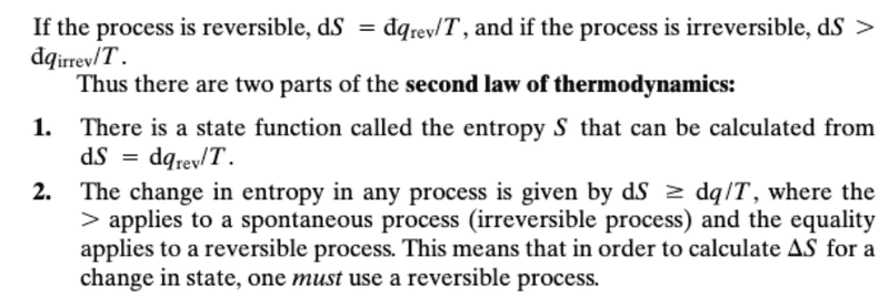

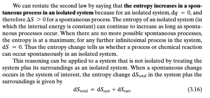

Here are a few snippets that directly generated the question in the OP
Does this answer your question about what the definition of isolated system is in this book?
As I understand it, our entire system is inside of rigid walls (no ##PV## work) that are adiabatic (no exchange of heat with surroundings). Thus, ##\delta q=\delta w=dU=0##.
If this is all correct, then I re-ask my question: why is ##\delta q_{rev}## not zero but ##\delta q## is?

Just some quick remarks: just as you say, dq = 0 for an isolated system.
Now in this system there can be processes which are either reversible or irreversible, leading to dS = 0 or dS > 0.
If an irreversible process happens inside the isolated system we can't calculate dS directly however, because dS = dqrev/T.
What we need to do is find a reversible process which has the same effect on the system as the irreversible one that's actually happening (i.e. same initial and final states).
For this "replacement process" dq > 0. In other words it's not possible to carry out this process if the system is isolated. We would have to add some heat from outside the system to make it happen.
