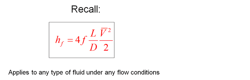

Hello,
I was wondering if when calculating the fanning friction factor, do english units need to be used?
The equation for the head friction is
h_f = 4f(L/D)V^2/2
where L is the length, D is the diameter of the pipe, and f is the fanning friction factor. This ends up having units of length squared/time squared, but I think it should be power/mass
Is the g included whether you use english units or not? I get confused when I need to divide by g or not these days since we keep going back and forth with english and SI units
Yes, the g is always there, even in SI or furlongs per fortnight units. Do a dimensional analysis and confirm.
You can see why I was confused, this is directly and repeatedly on the lecture slides
  • Slide titled Recall: with a boxed red equation h_f = 4f (L/D)(V-bar squared / 2) and the caption Applies to any type of fluid under any flow conditions.
