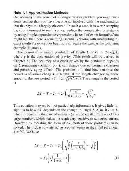

In the section on approximation methods, the formula for the period of a simple pendulum of length ##L## is given by:
$$T_0 = 2\pi \sqrt{\frac{g}{L}}$$
I am no expert on simple harmonic motion, but it is clear that the equation is dimensionally incorrect.
The problem is, the power series used is in accordance with the (possibly) faulty expression I wrote above. Thoughts?
  • Textbook page titled Note 1.1 Approximation Methods, with printed text and equations: pendulum period T0 = 2π√(g/L), the change ΔT = T - T0 = 2π(√(g/(L+l)) - √(g/L)), and a power series expansion in x = l/L ending in ΔT = T0(1/√(1+x) - 1), equation (1).
Yes I would say that is a mistake - the fraction is the wrong way up. I had a feeling it was, but I checked and Wikipedia agrees. Their equation is given with a citation, but if you prefer, I have found Hyperphysics a reliable source of help with physics problems, and it shares my view.
