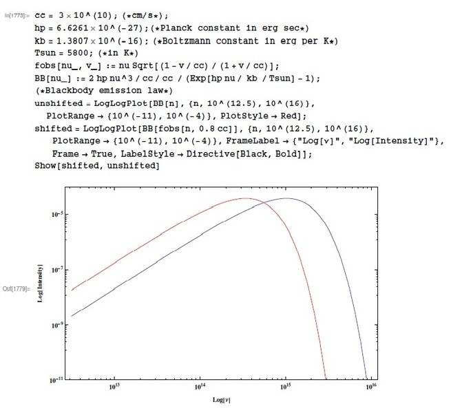

PAllen & Vanadium: do you guys agree with this plot?
I have no idea what that plot is saying. Nonetheless, if you can see the sun, and you start moving toward it, you can still see it.
First, a quick question that you've never answered (I'm afraid I'm fearing the worst). Can you view the reference link I posted, and did you read it?
You don't define your variables, but I think the idea is that BB is the spectral radiance, as per
http://en.wikipedia.org/wiki/Planck's_law
If you refer to the paper, which I *really hope* you're reading, you'll see that the paper uses the alternate formula from the wiki, where they use ##\lambda = \frac{c}{\nu}## instead of ##\nu##, ie in terms of wavelength rather than frequency.
This gives eq 12 of the above paper, which is equivalent to your own but in terms of wavelength rather than frequency.
eq 13 gives the actual received power / unit area, if the stars radius is a and it's distance is R.
Your transformation to the moving frame is incorrect, however.
The spectral radiance in the moving frame is D^3 times the spectral radiance in the stationary frame - see eq 11.
When you integrate this out, you find that the total energy recieved, integrating from lambda from 0 to infinity should scale as D^2. (D being the doppler factor). At least if you can get the integrals to work out - maple doesn't want to do them for me, and I don't even want to attempt to do them by hand.
The appendix to the paper gives a short derivation of why D^2 is correct for the total intensity. You can refer to the "photon arrival" thread for perhaps a clearer discussion, the gist is that the shift in energy per photon gives one factor of D, and that the photon arrival rate also increases by the doppler factor D, giving a total intensity increase of D^2. You can also try the Wiki article on "relativistic beaming" http://en.wikipedia.org/wiki/Relativistic_beaming.
If you evaluate your integral that you give in the moving frame, you should see that the intensity does NOT increase as D^2, but much faster. (If you can get the integral to evalutate, that is - good luck with that!. )
But anyway that is where you appear to have "gone wrong".

pervect said:
What was unclear about the detailed answers in the last thread? In particular the answers given by the paper http://cartan.e-moka.net/content/download/248/1479/file/Astronave relativistica.pdf in figure 4.
That paper first quotes the black body power density spectrum for the rest frame S, in which the star has radius 'a' and distance R, and then it applies the cubed gamma Doppler factor to transform the power density spectrum to another frame S', but it continues to use 'a' and R as if they are invariant between S and S'. Note that the derivation leading up to their equation 11 doesn't account for the change in the solid angle due to the effects of aberration on 'a' and length contraction on R, and they use equation 11 to transform the power density, going from equation 13 to equation 14. The power spectrum is defined per unit area of emitting surface AND per unit solid angle, and these are not invariant when changing frames. If the densities in S and S' are defined consistently relative to their own frames, another factor is needed to account for the geometric effects, but no such factor appears in the paper. That's why I'd say that although their results are qualitatively correct (with the visible brightness first increasing and then dropping off for greater speeds), they aren't quantitatively correct.
There's a good reason for that - the radiation is only spherically symmetric in the rest frame. What the paper is doing is analyzing the problem in a purely cartesian coordinate system, (one local to the observer) in which there is no solid angle, and the source is essentially pointlike.
They do the boost in said Cartesian coordinate system. Notice that eq 1) uses t,x,y,z - you won't see any solid angles anywhere when they're doing the boost. That's your clue as to why there isn't any consideration of the solid angle.
They do do a conversion, "in passing", to convert from the solid-angle formalism to the simpler to analyze cartesian coordinate system, when they introduce a/R^2. They do this conversion in the star's rest frame, the only place where the radiation is symmetrical.
They're not concerned with the solid angle, as they are assuming that the star is pointlike.
One is certainly free to analyze the problem in this manner, and it would be instructive. One would expect the results to agree with the (IMO, simpler) approach in which one treats the radiation in a local cartesian frame, as the paper does. It's a matter of choosing the coordinates you like best and which are easier to work with.
If the star is NOT pointlike, there is an additional increase in intensity, due to the fact that the star shrinks its angular size.
However, when you are unable to resolve the disk of the star (which is the case that one would expect), there is no angular size to shrink. The optics of the reciever (in this case, the eye) smear out the star over a greater solid angle than the star actually occupies, due to diffraction and whatnot. The approach taken by the paper treats this case (which is what one expects, one does not expect stars to show a disk). I think it treats it in a simpler manner than introducing the solid angle would -, if you really like spherical coordinates, feel free.
That's the problem. They apply the factor (a/R)^2 to account for the solid angle, but they apply that same factor in both S and S', whereas it represents the solid angle factor only in S. When they write their density function in S' they need to account for the change in the solid angle. (By the way, this has nothing to do with what coordinate system we use.)
pervect said:
...you won't see any solid angles anywhere when they're doing the boost...
Right. That's the problem.
It's permissible to assume point-like for purposes of saying all the light is coming from the same direction with the same Doppler shift, but no matter the size or distance of the source we can't neglect the effect of the solid angle on brightness. Two stars with the same surface brightness at the same distance will have different optical brightness viewed from the Earth if one is twice as large as the other, even if they are located many light years away so that we can't resolve either of their disks. If we really wanted to neglect the solid angle, we would have to introduce a delta function for the intensity, so the integral of an infinite intensity over a zero surface area would give a finite result. But they haven't done this.
pervect said:

Not only did I read it, but I also emailed it to a few professors. They laughed! I guess it's time to update that paper.
Yes, I thought so, too. But then I consulted a couple of profs. and they said they couldn't find anything wrong with it. Furthermore, they agreed that when you plot the intensity as a function of photon frequency plus the proper reference frame of the emitter and receiver, along with the coordinate transformations between the two frames and, finally, the transformation from coordinate quantities to a physically-measurable ones, you get an intense UV-Sun.
