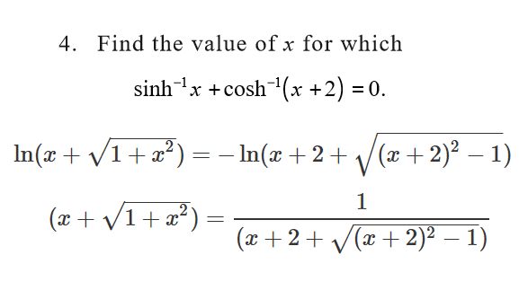

Handwritten-style worked solution: problem 4 asks for x with sinh^-1(x) + cosh^-1(x+2) = 0, followed by ln(x + sqrt(1+x^2)) = -ln(x + 2 + sqrt((x+2)^2 - 1)) and a step rewriting it as (x + sqrt(1+x^2)) = 1 / (x + 2 + sqrt((x+2)^2 - 1)).
The attempt is in the picture. Is this the right method? Is there any faster method without cumbersome calculations?

@Clara Chung: The problem is, if you look at the graph it looks like there is a solution ##x=-\frac 3 4##. And you can check that works exactly in your last equation of your original post but not your root solution.

So it is x^2=x^2+4x+3
X=-3/4
