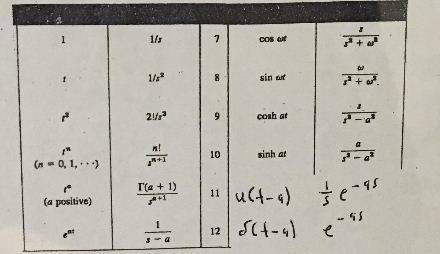

Not according to the table..
In your other thread, you used a property (the delay property) that wasn't listed in the table you posted. You want to find one of those properties.
