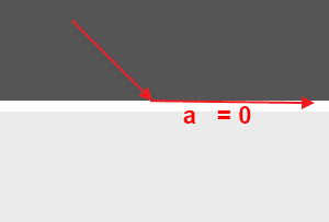

A ray is coming at a grazing angle (above critical angle) from the optically denser material through the gradient. Will the ray be bent perpendicularily from the normal, traveling in straight line perpendicular to the normal no mayter how steep is the gradient?
I assume he's asking this:
1] If you have a ray impinging on an interface between two materials, is it possible to have a refractive index so high that the emergent ray is effectively 0 degrees - parallel to the interface?
[ EDIT ] Nope. The more times I read the OP the less sense it makes - esp. the very last phrase in parentheses.
Your picture is accurate to what i was asking about, except there is a smooth transition between high and low index, not an interface. I know that for a sufficiently "slow changing" gradient this is possible. The question is if there's a limit to how "fast changing" gradient can be so that it behaves the same way
A systematic way to derive ray optics as a limit of wave optics is the so called eiconal approximation. It also allows to estimate the errors neglected due to the change of the refractive index. The book by Born and Wolf is certainly a good starting point.
