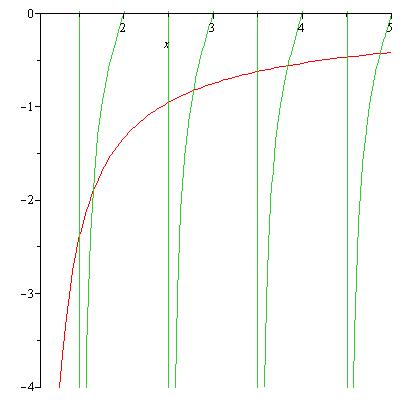

Those boundary conditions look like Sturm-Liouville type B.C.'s, and you wouldn't normally expect a non-zero solution for any old value of the constant, which is ##9## in this problem. For example, consider the eigenvalue problem$$
y''+\mu^2 y = 0$$ $$y(0)+y'(0) = 0,~~y(\pi)-y'(\pi)=0$$Sturm-Liouville theory tells us there should be infinitely many eigenvalues ##\lambda_n=\mu_n^2##, with corresponding non-zero eigenfunctions (solutions). Is one of the eigenvalues ##\lambda = 9##? The answer is "no". Without boring you with the details, if you work out the details, the ##\mu_n## are solutions of the equation$$\tan(\pi \mu) = \frac{2\mu}{1-\mu^2}$$They can be found numerically and are where the functions ##\tan(\pi \mu)## and ##\frac{2\mu}{1-\mu^2}## in the picture below cross.
Unfortunately, ##9## isn't one of the eigenvalues, which is why there is only the trivial solution.
[Edit, added]: Note ##\lambda = 9## would correspond to ##\mu = 3##.
Unfortunate that the graph doesn't clearly demonstrate this by having the horizontal axis include [itex]\mu = 9[/itex].

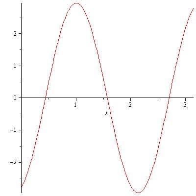

[Edit] This may need correcting, stay tuned...
OK, the below is corrected.
@pasmith: I was apparently asleep when I first replied. For ##\lambda = 9## we need ##\mu## near ##3##, which is illustrated in my previous post. The ##\mu## value nearest ##3## is 2.780188423. This leads to a solution of y = sin(2.780188423*x)-2.780188423*cos(2.780188423*x). Here's a graph:
