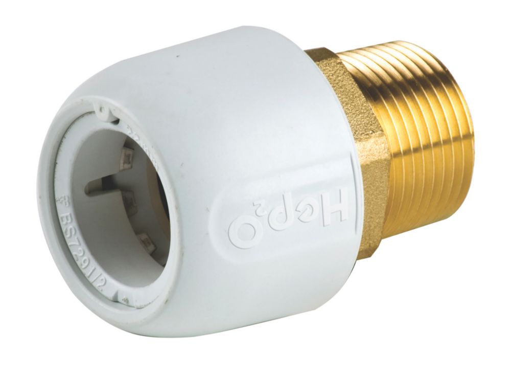

Is there a "ground union" type of fitting that can be installed in PEX lines without requiring additional adapters that screw into the fitting?
I need to plumb a whole house sediment filter. Ideally, I like a union fitting that was PEX on one end and threaded on the other. This would allow me to re-do the connection to the filter housing if the first test showed it leaked. It would also allow easier replacment of the filter housing if that is ever needed.

At one time, the mating parts in a ground union were ground together with a polishing compound to get a leak-tight metal-to-metal seal. This is still done to valve/valve seats in high performance automotive engines. These days I think unions are just machined with a flare to achieve a seal, but the name endures.
These are readily available in the UK for a number of plastic pipe solutions e.g. https://media.screwfix.com/is/image//ae235?src=ae235/5653F_P (Hep2o is a PB system which I do not believe is permitted in the US) but you would need to find one suitable for your US supplied pipe.
If there is not a specific fitting available then use a compression adaptor to join the PEX pipe, using the correct insert (I assume this is allowed/available in the US?)
