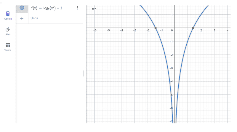

Write the coordinates of points where ##f(x)=\log _{2} x^2 -1## intersects x and y axis
##\log _{a} x^n = n\times \log _{a} x##

But apparently, that is not the only solution. There should be another answer with a negative sign so (##\pm\sqrt{2}##, 0) would be a complete solution for points at which graphs cross the x line. There are no points where the graph crosses the y-line.

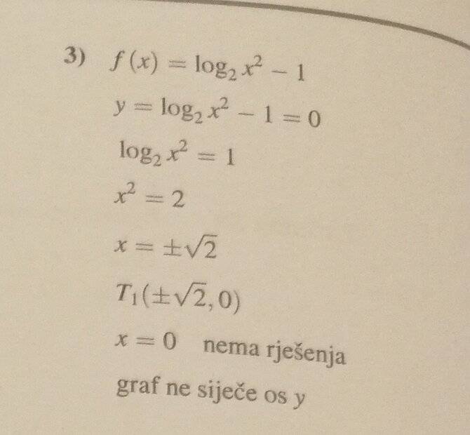

This is how it's solved in the textbook(pic in attachments). And I understand that it's correct because the graph really does cross the x-line in those points.
So, my question is, is there a rule I am not aware of that states that I can't divide an equation with n(exponent of an argument moved down to the front)?

From line 2, you have ##\log_2(x^2) = 1 \Rightarrow x^2 = 2 \Rightarrow x= \pm \sqrt 2##

It's because your relevant equation -- ##\log_a (x^n) = n\log_a(x)## -- is valid only for x > 0. Although ##x = \sqrt 2## is a solution of equations 2 and 4, ##x = -\sqrt 2## is also a solution of the original equation.

You have to use ##\log_2 x^2 =2\cdot \log |x|## since the logarithm doesn't allow negative arguments. Therefore you end up with ##2^{1/2}=\sqrt{2}=|x|## which includes both signs!
