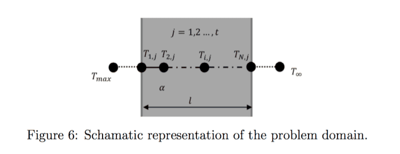

It is 1D transient heat diffusion problem. x[0,L] represents a 1D spatial domain and t[0,tao] represents a time domain. T(x,t) is temperature distribution over the spatial and temporal domain. \alpha = k/(cp*rho), where k is thermal conductivity, cp heat capacity and \rho thermal conductivity.
what is ##T_{\max}##
T_max is a constant value. T_infinity is also a constant value.

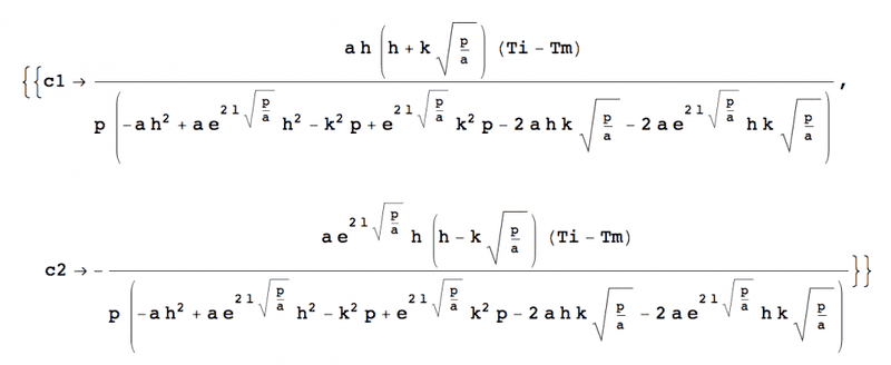

I have got the following Laplace transform
$$\hat T(x,p)=\frac{T_\infty}{p}+C_1e^{x\sqrt{p/\alpha}}+C_2e^{-x\sqrt{p/\alpha}}$$
then we have two equations:
$$k\hat T_x(0,p)=\frac{hT_\max}{p}-h\hat T(0,p),\quad k\hat T_x(l,p)=h\hat T(l,p)-\frac{h T_\infty}{p}$$ and two unknown functions ##C_j=C_j(p),\quad j=1,2## I do not see what is the problem
Thank you for the solution. It is possible to find C1 and C2. I got as follows (picture attached) a = alpha Tm = T_max, Ti = T_inf. I am stuck again..how can we find inverse laplace ?

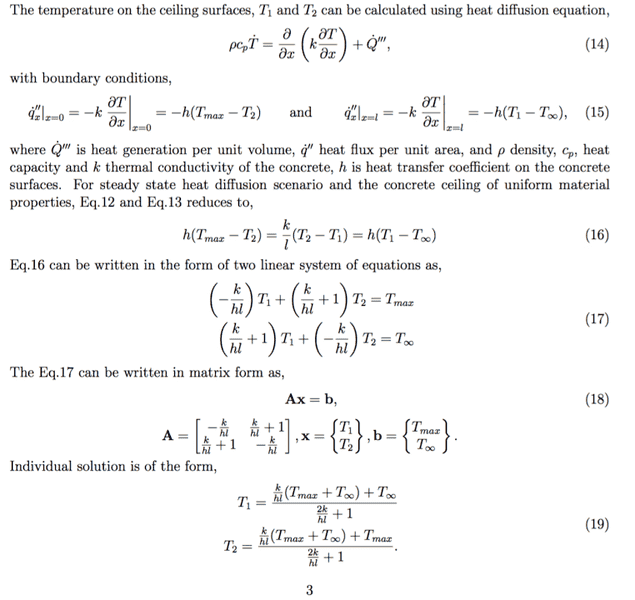

Hi
I have following analytical solution (Please find it in the attachment). T1 and T2 are temperature at the surface of inner and outer wall.

deepakphysics said:
Hi
OK. Let ##T(x,\infty)## represent this final steady state solution. Now express the temperature at an arbitrary time t as follows:
$$T(x,t)=T(x,\infty)-\theta (x,t)$$
Now, if you substitute this into the differential equation, boundary conditions and initial conditions, what do you get (in terms of ##\theta##)?

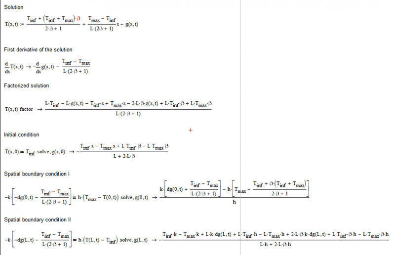

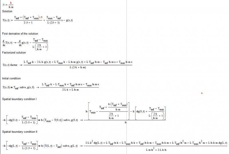

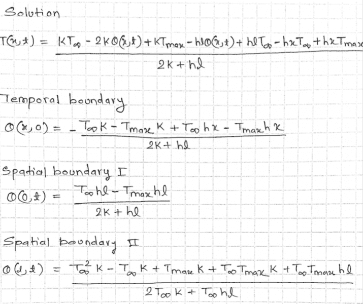

This is what I got. One more thing, T_infty is not the temperature corresponding to steady state solution. It is a ambient temperature. For some reason it should be taken as a variable. The results need to be expressed in terms of T_infty and T_max and other material parameters (h, l, k ).
I understand all this. Now please answer my question in the previous post.

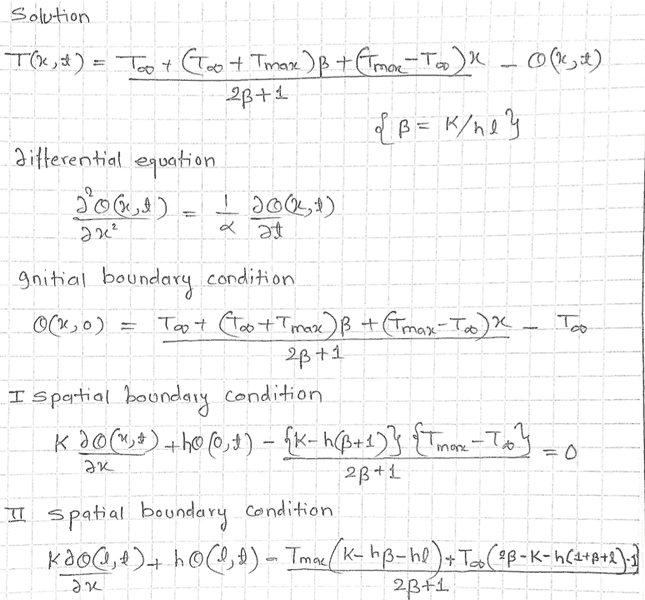

There is a mistake in your equation for ##T(x,\infty)##. The x should be an x/l. Please make this correction in your initial condition and boundary conditions, and also reduce these equations to a common denominator.

Thank you for the correction. Please find the updated results in the attachments.
My solution for ##T(x,/infty)## does not match yours. Based on the boundary condition equations you gave in your first post, I get:
$$T(x,\infty)=\frac{-T_{max}+\beta (T_{max}+T_{\infty})+(T_{max}-T_{\infty})x/l}{(2\beta -1)}$$
Note the minus sign in the denominator. Try this and see if it satisfies you boundary conditions.
I suggest that, when you do the formulation in terms of ##\theta##, you continue to use ##\beta## in the equations.
I think I did little mistake in the first post. There should have been a minus sign in the left hand side of both equations representing spatial boundary conditions. Also I did mistake in my previous reply. I think I have corrected those mistake this time. Please find the outcome in the attachments I) in terms of \beta and ii) interms of (k,h and l).
Yes. I missed this. I'm editing your original post to correct this.
I'll check it out in a little while.
I couldn't read what you had, but here's what I got (for the corrected boundary conditions):
$$T(x,\infty)=\frac{T_{max}+\beta (T_{max}+T_{\infty})-(T_{max}-T_{\infty})x/l}{(1+2\beta)}$$
Initial condition: $$\theta (x,0)=\frac{(T_{max}-T_{\infty})(\beta + x/l)}{(1+2\beta)}$$
Boundary condition at x = 0:$$\frac{\partial \theta}{\partial (x/l)}=\frac{\theta}{\beta}$$
Boundary condition at (x/l) = 1:$$\frac{\partial \theta}{\partial (x/l)}=-\frac{\theta}{\beta}$$
