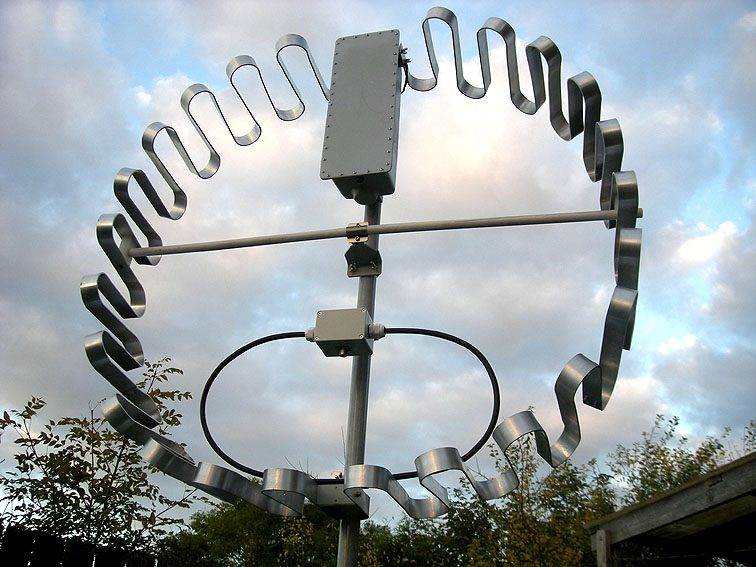

Here's a fun one I found with Google Images:
http://www.mixw.co.uk/MagLoop/photo/MLF_1_20.jpg

How is the performance?
Beats me, I just found it on Google Images and thought it looked cool. You can click on the URL to get to the website to read more about the antenna if you like. :smile:

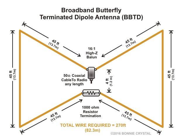

phinds said:
The figure you provided is of triangle shape, furthermore, the feedline is at the center.
Note the picture I provided, the feedline is at the two of the center of the circle and they can communicate.
