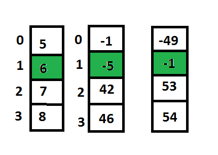

There are given three vectors $V_1, V_2, V_3$ of dimension $m$, the elements of which are real numbers. I want to write an algorithm that determines if there are three numbers, one of each of the matrices $V_1, V_2$ and $V_3$, that have sum equal to $0$.
  • Can you write an $O(m^3)$ algorithm?
  • Can you write an $O(m^2 \log m)$ algorithm?
  • Can you write an $O(m^2)$ algorithm?
  • Can you find a quicker algorithm that $O(m^2)$ ?
That's what I have tried:

Because I tried to apply this algorithm: http://http://pastebin.com/9H4mL76P
at these three vectors:
View attachment 4362but we don't find that the marked numbers satisfy the desired property, although they do... (Worried)

Let's run through the algorithm as it should work. (Thinking)
Suppose we have already iterated through i and now have $v_1=6$.
Then:
\begin{array}{|c|c|c|c|l|}
\hline
v_1 & v_2[j] & v_3[k] & \sum \\
\hline
6 & -1 & 54 & 59 \\
&& 53 & 58 \\
&& -1 & 4 \\
&& (-49) & (-44) & \text{too far}\\
& -5 & -1 & 0 & \text{we continue where we were and we've found it!}\\
\hline
\end{array}
(Emo)

Why do we delete from $v_1$ all the other numbers except from $6$ and from $v_2$ all the other numbers rather than $-1,-5$? (Thinking)
I have skipped over the earlier iteration of $i$.
Perhaps you can say what it should look like? (Wondering)
In $v_2$ we've stopped at $-5$ since there is no need to continue - we have found a solution! (Party)
Ideally the algorithm breaks off at this point unless we want to find all possible solutions. (Nerd)
