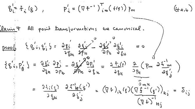

Consider the following change of variables in phase space f: maps the reals and is smooth and invertable change of coordinates Q=f(q), q = f-1(Q). Given f, define a change of variables on phase space (q,p) -> (Q,P) by the pair of relations
Pj = (∇f-1)Tjk(f(q))pk
q runs from 1 to n
show that its canonical.
I know that for this to be canonical
(dQi/dqj)(q,p) = (dpj/dPi)(Q,P)
(dQi/dpj)(q,p) = -(dqj/dPi)(Q,P)i'm having a couple problems, is f the generating function that i have to find explicitly?
Can i use the sympletic method such that MJM^T = J
what is the point of the transpose for the (∇f-1)Tjk part for? i thought f had to be symmetric.
for Pj it can equal
(∇f-1)TjkQpk
=(∇f)T *-1jkqpk
but for that to be true then (∇f-1)Tjk has to be symmetric therefore the transpose dissapears
looking at my notes, i think this is supposed to be the associated point transformation in phase space
Guess i can answer my own question... i knew how to do it but i had an error in my notes
[dQ, dP)T = [{dQ/dq, dQ/dp}, {dP/dq, dP/dp}]*[dq, dp] = Mij*[dq, dp]
to prove its a canonical transformation
MJMT = J where J = [{0,I},{-I,0}] and T represents the transposeIf i do the matrix multiplication and say:now i will let {a,b} where a and b are some arbitrary coordinates be the poisson brackets
MJMT = [(0,{Q,P}), (-{Q,P},0)]
It is known that {P,P} = 0 = {Q,Q} and {Q,P} = δij
Using the following vvvv
and there you have it
