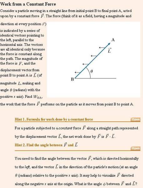

i can't figure out the answer to hint 2
w = f deltar

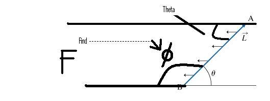

w = F cos theta (deltar)is this img right?
Your diagram looks good to me. Now how will you make use of it to find the dot product [itex]\vec{F}\cdot\vec{L}[/itex]?
thats what i have been trying to figure outi have tried to relate angles and got

[tex]W = F L \cos \phi[/tex]
Express this in terms of [itex]\theta[/itex].
I know how to set it up that's is not what i am trying to figure out,
im trying to express PHI in terms of THETA, u see my IMG where it says FIND THIS i can't find that angle, i know how my FINAL answer is going to be expressed.
i can't figure out the how to answer the HINT 2: questionit will be cos ( of some stuff in here * pi /180)
Hint: [itex]\phi + \theta =[/itex] ?
(Note: The angles are already in radians.)
180..
i have tried cos ( (180 - theta) * (PI /180))still wrong
The angles are in radians, so no need to convert to radians:
[tex]\phi + \theta = \pi[/tex]
Now find [itex]\cos\phi = \cos(\pi - \theta)[/itex]
(Review your trig identities if you need to.)
in rads it would = PI..
phi = pi - thetai have never seen that before in my life..
thanks for your help
So... what's your final answer?
L*F*cos(PI-THETA)

L*F*cos(PI-THETA)
OK, but you can simplify it a bit further using a trig identity. (And get rid of that [itex]\pi[/itex].)
-cos(theta)
nightshade123 said:
-cos(theta)
Exactly! :cool:
