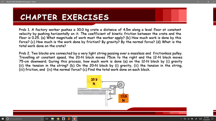

Problem # 1
Work done by several forces
w=f * d cos theta
w=mg
n=w
I can't figure out how to solve a) and b)
NOT SURE:
so my attempt a) f = mg = 30kg*9.8m/s^2 = 294N =magnitute of the force must the worker apply.(NOT SURE)
b) WofF= f d cos theta = 294N * 4.5m * cos0 = 1323N

First, it seems you have misunderstood the questions (a) and (b). It also seems that question (a) has a typo. I believe the first two questions should read
(a) What magnitude of force (not work) must the worker apply?
(b) How much work is done by this force?
There are only 4 forces exerted by (1) the worker, (2) gravity, (3) normal force and (4) friction.
It also seems you think that Work = Force × Distance. This is not necessarily true and is not true for some of the forces here. Please look up the definition for work done by a constant force and apply it correctly.
Finally, you are told that the crate is moving at constant velocity. What must be true for this to be the case?

This is correct. It is not correct that the force exerted by the worker is zero. The worker must exert a force otherwise the crate will not move. Given that the crate is moving and that its acceleration is zero, what must be tru about the forces acting on the crate?
since there is no acceleration therefore,
F - fk = ma = 0
F = fk ?
so F is basically fk?
so work done by F is the same as work done by fk?
In magnitude. The work done by fk is negative while the work done by F is positive.
oh okay, because cos 180 is -1. okay Sir. Thank you for the help ^ _ ^
