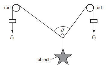

An object hangs by means of two cords around two rods, as shown. The object is held in equilibrium by the forces F1 and F2. The object weighs 10N. There is negligible friction between the rods and cords. Angle θ is 90°. What are the values of F1 and F2?
*Hint: Both the forces are different in magnitude.
Fx = Fcos(θ)
Fy = Fsin(θ)
Hello,
I have tried to resolve this using the fact that we consider the weight to be normal, so I resolved the tensions in both the strings using an angle of 45 degrees. Upon solving these simultaneously T2*cos(45) + T1*cos(45) - 10 = 0 , T2*sin(45) - T1*sin(45) = 0, I have gotten T1 = 5√2 and T2 = 5√2. And as T1 = T2, thus: F1 = 5√2 and F2 = 5√2. However using the hint guidance provided this is incorrect as they are the same. Can anyone show me the right way and where I have gone wrong?
I guess you mean vertical ('normal' means something different).
Looks like you have assumed the 2 sloping string-sections are both 45∘ to the vertical - which is wrong; if you don't understand why, you need to revise what it means to resolve a vector into components.
You don't know the 2 angles (only the fact that they add up to 90∘).
Your first step is to ask yourself: what are the tensions in the left and right strings? Remember, each string passes over a (presumably frictionless) rod.

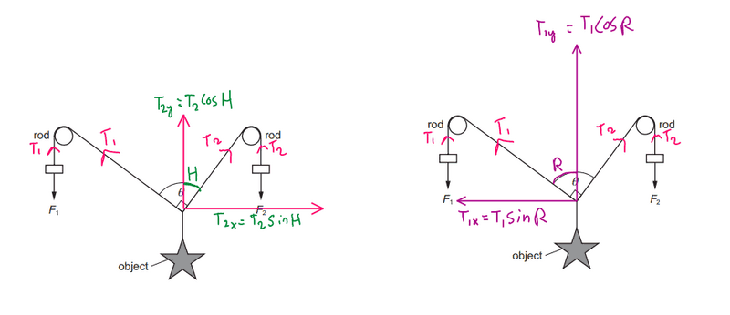

Is this correct now?

Draw a vector addition diagram showing how the three forces acting on the knot add to give zero. Do you see that they form a right triangle?
Yes - but resolving into components won't help. Use @kuruman's approach in Post #4.

##F_1## and ##F_2## are both variable. So I still think we have to use ##\sum F_x = 0 \sum F_y = 0##, in conjunction to post 4 to land this one (three variables-three equations)?
If I'm missing something, I'll wait to see what the OP figures out.

Worth noting that (unless I'm mistaken) the problem has a serious error. There are no unique solutions for ##F_1## and ##F_2##. But there is a unique relationship between ##W, F_1## and ##F_2##.

With the parameters given, the relationship between ##W, F_1## and ##F_2## is easily shown to be ##W^2 = F_1^2 + F_2^2##.
From the diagram, we see ##F_2>F_1##. Since ##W = 10N##, two of the (infinitely many) solutions are, for example:
##F_1 = 6N## and ##F_2 = 8N## (Edit - this is the only integer solution.)
##F_1 = \sqrt {19}N## and ##F_2 = 9N##
Each solution has diffferent values for ##\alpha## and ##\beta## but ##\alpha + \beta## always equals 90##^\circ##.
The question is faulty!

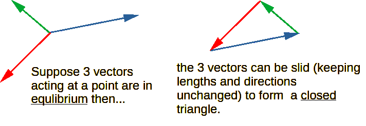

Using components is not always the best or most approppriate way to add vectors. I used a vector addition triangle. A lesson on vector addition wouldn't be appropriate here, but consider this:
Can you apply this method to the original question?

Because it's more complicated. If you consider that the sum of forces can be represented as a closed triangle, you will see immediately that there is no unique solution.
Look at the figure figure below. On the left you have the two vectors (bold means magnitude and direction) ##\mathbf T_1## and ##\mathbf T_2## at right angles to each other and with their tails together. To find their sum, slide ##\mathbf T_2## parallel to itself until its tail is at the tip of ##\mathbf T_1##. Then the sum of the two vectors has magnitude equal to the hypotenuse of the right triangle.
The sum of the three forces acting on the knot must be zero, $$ \mathbf T_1+\mathbf T_2+m\mathbf g=0$$which says that the hypotenuse must be equal to the weight, ##mg=10~##N. Thus $$\sqrt{T_1^2+T_2^2}~=10~\text{N}.$$How many ways are there to add the squares of two numbers, take the square root and get 10?
