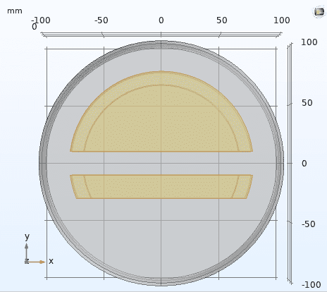

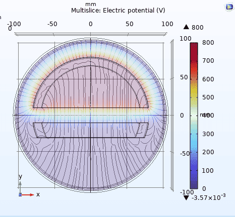

TL;DR
In this COMSOL model, I have a part given potential (-800v) while the other is grounded.
Does anyone have an idea on how to change the potential alternately from +800v to -800v with a waveform function?
V0*wv1(sin(f*t))
Does this equation satisfy this query with a frequency given as 2.81 MHz?
Any suggestions?

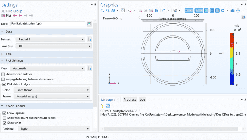

This is actually for a particle tracing to be done further for a proton.
Kindly find the images for better understanding.
You'll have to use a model that allows for time-dependent solutions, probably Electric Currents in your case.
