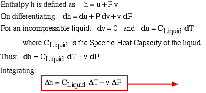

I don't understand why you say that it is incorrect. Here's an example of what is taught at Ohio university about steam power plants:
In order to determine the enthalpy change Δh of the cooling water (or in the feedwater pump which follows), we consider the water to be an Incompressible Liquid, and evaluate Δh as follows:

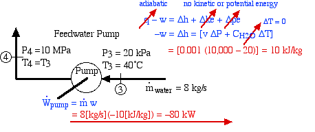

We now consider the feedwater pump as follows:

Hi Jack Action,
The original problem statement didn't say anything about an open system (flow process). In fact, it seems to imply a closed system of 1 kg.
For an open system, your description is certainly appropriate, with the change in enthalpy per unit mass of water passing through the system (at steady state) equal to minus the shaft work. For a closed system, of course, the development you provided does not apply.
It is not clear whether this homework assignment was designed to give the student experience with applying the open system version of the first law.
In any event, in my previous post, I though it might be interesting to develop the closed system solution for compression of 1 kg of water at constant entropy. Any interest?
Chet
