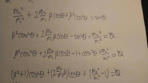

Alright. This is what I have tried... I don't know if it's entirely correct but it still seems really clustered.
I don't know what to do next though...
You got a quadratic equation for cosθ. Solve with the quadratic formula.
ehild
Hi, just attempted with quadratic formula, but I can't get anywhere (as in I can't simplify it any further it looks so hideous).
You can simplify it a bit, by expanding the parentheses under the square root. And don't worry if it is not simple.
