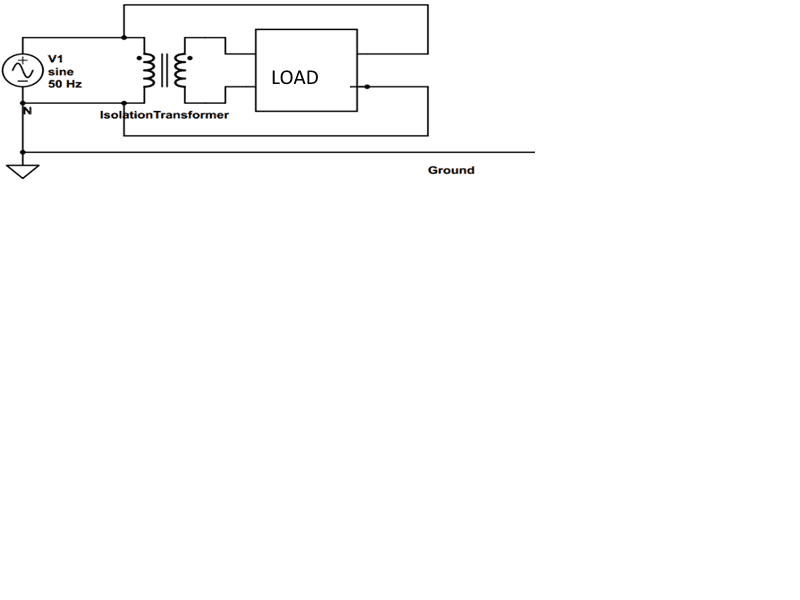

The discussion centers on the connection of the load to the primary side of an isolation transformer. Participants emphasize that connecting the load to the primary side undermines the purpose of the isolation transformer, which is designed to provide electrical isolation and safety. The consensus is clear that such a connection is not advisable. The importance of maintaining proper transformer function and safety standards is highlighted. Overall, the conversation stresses adherence to correct wiring practices for effective isolation.
