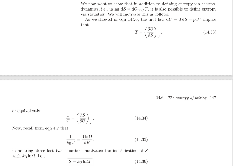

Given ##\frac{1}{kT}=\frac{d\ln(\Omega)}{dE}##, derive an expression for entropy
##dU=dQ+dW##
Okay, so we have that $$dU = \left( \frac{\partial U}{\partial V} \right)_S dV + \left( \frac{\partial U}{\partial S} \right)_V dS$$ And comparing that to the first law, we get that $$T=\left(\frac{\partial U}{\partial S}\right)_V$$. Comparing expressions of ##T##, $$\left(\frac{dE}{dk\ln(\Omega)}\right)=\left(\frac{\partial U}{\partial S}\right)_V$$, it ALMOST seems like ##S=k\ln(\Omega)##. But I have one doubt about the constant volume... why isn't this an issue?
This is a weirdly stated question. What exactly are you being asked to prove? Typically the entropy is defined by ##S(E) = k \log \Omega(E)## and the temperature is defined by ##\tfrac{1}{T} = \tfrac{\partial S}{\partial E}##.
This is from Blundell and Blundell.
That's only one of many possible definitions of entropy.
If you add any function of V alone to the right hand side of (14.36) it still works out.
I thought ##S=K_B\ln\Omega## though. If ##S=B(V)\cdot K_B\ln\Omega## instead where ##B## is a function of ##V##, surely they are not the same.
Add, not multiply!

@laser1, does that solve your inititial problem?
yeah thanks, basically having V constant changes nothing as it gets wiped out when the derivative is taken
I'm wondering whether (14.35) ( or (4.7) ) in Blundell is accurate.
Maybe there should be a partial derivative there too.
Have you checked how they come up with (4.7)?
Also I don't think the homework from the first post should ask for a derivation.
What Blundell gives is just a justification. They find an expression that's compatible with classical thermodynamics, but they don't derive the only possible expression.

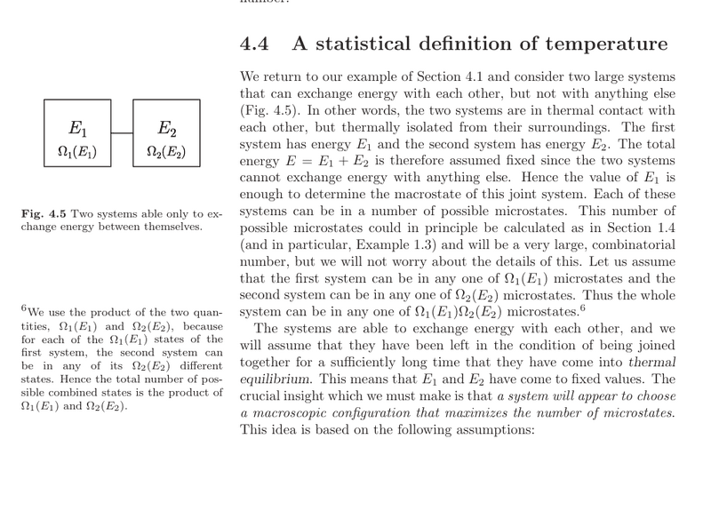

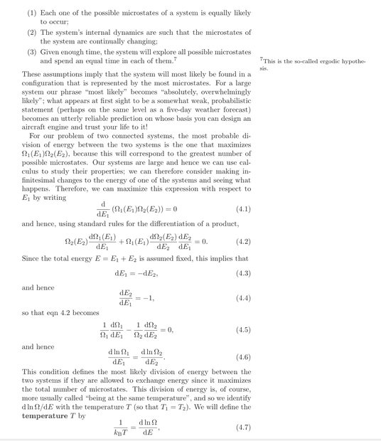

I have attached the part of the book. I mean, the two systems are fixed, so perhaps we can say constant volume?
Regarding the derivation part, this was the first time in the book that ##SK_B\ln(\Omega)## was mentioned! btw, as for the question, I did not find it in the book/lecture notes, I made it up myself. Which is perhaps why when seeing it for the first time and being familiar with ##SK_B\ln(\Omega)##, one would be confused.
I see. I wouldn't ask for a derivation. I don't think you can derive statistical entropy from something else.
I agree. They state that the total energy is fixed, which includes that the system is not doing any work on the surroundings. So I would just assume the simplest, i.e. both volumes constant.
I think they should use partial derivatives at constant volume in the whole argument.
