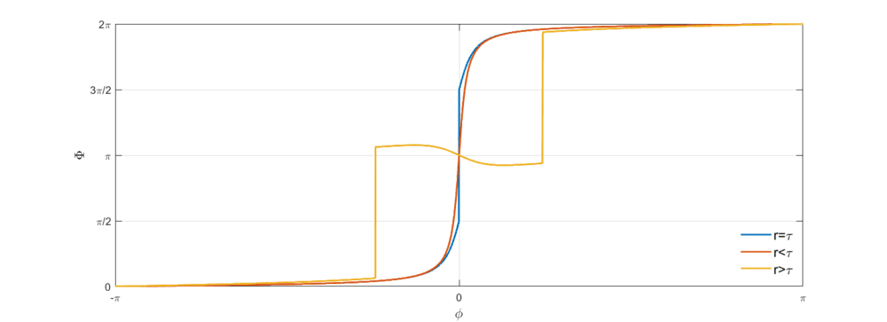

Here is a picture of these plots from a paper:
244814

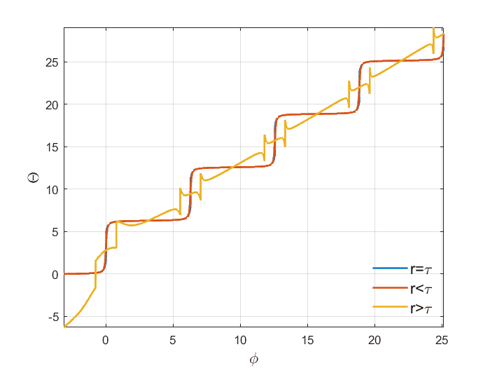

When I try to reproduce the 3rd graph above (yellow line below), I get sharp discontinuities:
244815
Those jump discontinuities should not occur, and the function should never rise to the high value of the two other plots. So, what could be the cause of this problem? :oldconfused:
Any suggestions would be appreciated.
The only way discontinuities can arise is when you divide by 0. Have you calculated where one of the denominators in your expression becomes 0 and where the discontinuity arises? Did you get a match?

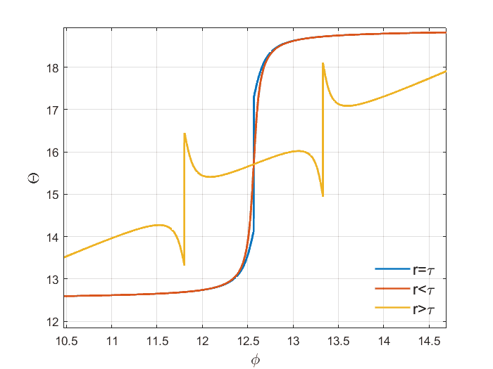

Thanks for all the suggestions. I tried the method suggested by @DaveE and @George Jones and used atan2. But I am still not quite getting the correct plot. Here is the result (yellow line):
244849
244850
The problem is that, the plot should not take the form of a staircase function. Unlike the two other curves, it should not keep going up. What is the problem here? :oldconfused:

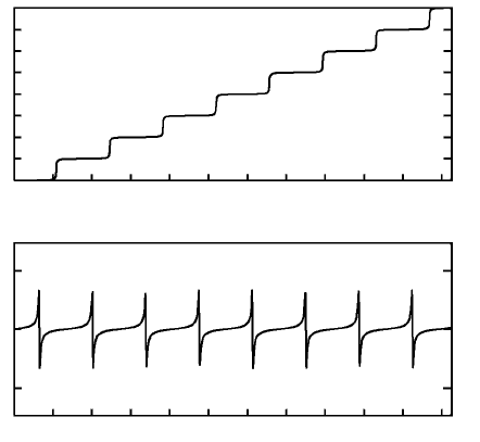

Here is what I should get from another paper (the bottom plot):
244851

I can not emphasize this enough: When a complicated equation is misbehaving, break it up and look at smaller parts.
You are using atan2 wrong. It should be like atan2((r*sin(phi)), (tau-r*cos(phi)))
The first atan2 still has jump discontinuities. MATLAB has an unwrap function that will stop the jumps and return a continuous variable. The second atan2 has no jumps in that case, but it is good to unwrap it also, just in case.
I think this code will give you what you wanted.
