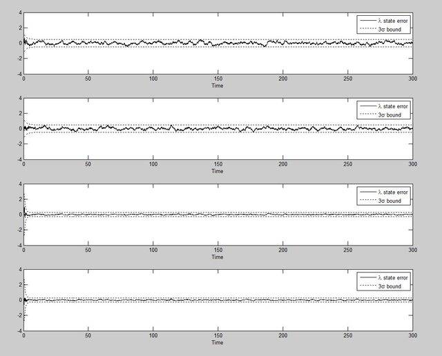

I think I have discovered the difficulty in dealing with the accelerometer noise when the acceleration is not made part of the state vector. Since the accelerometer measurements are used in the predict side of the filter, I get the random walk like you were talking about. I end up with state errors that drift.
Top to bottom: Position X, Position Y, Velocity X, Velocity Y
In the above image, my process noise covariance matrix is set to zero because I was assuming my process was perfect for the moment. But then I got to thinking, and added the accelerometer noise to the the process noise, and I came up with better results:
I'm not sure if what I did is correct or not, though. It seems like I should not have the accelerometer noise in the process noise of the model, but I should include it in the process noise covariance matrix only when I am propagating/predicting my error covariance matrix, P...
Can you shed some light on this?

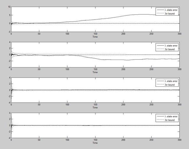

I am going to try to add my acceleration to my state vector, but it seems like in that case I need to know the derivative of the input...is this right?
You have to have process noise (aka plant noise). If you don't, the covariance matrix will collapse and the filter will reject measurements. Think about it: If the state is known perfectly, why bother with those stupid noisy measurements?
How much process noise? That's the black art of Kalman filters. It's called filter tuning, and it's usually done empirically. Basically, you want more than enough noise to keep the covariance from collapsing, but too much noise will make the filter outputs become noisy. Your state is staying within the 3 sigma bounds, which is a good start. Fiddle around with your process noise. Scale it up and down (maybe by quite a bit) to see what it does to behavior, repeat these coarse adjustments and then later fine tune until you get the behavior you want.
Note also that you need to account for behavior when you take your device off the test stand and start driving it with a (noisy) motor (or whatever). This is true plant noise; you'll need to add some of that plant noise to your empirically-based process noise that's needed just to make the filter behave nicely.
Thanks, that makes sense. I'll just have to experiment with the process noise to see the effect it has on the filter. So really you aren't ever accounting for the accelerometer noise...you just tune the process noise until it works?
I think adding the acceleration to the state vector would be worth doing, since I have an idea what the commanded acceleration is. But differentiating the acceleration to get jerk means I have to know the derivative of my input, right?
With regard to that random walk: The only way to get rid of that is to take other measurements. Cameras. Star trackers. Magnetometers. Lidar measurements. GPS. Radar range/range rate. All kinds of other sensors are used. If you don't, your position will degrade rather quickly. Adding these sensors will of course make your Kalman filter get bigger and bigger.

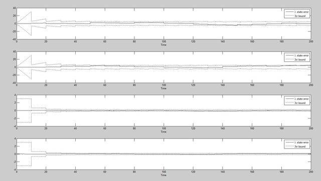

Here's an example with the GPS updating every 10 seconds (accelerometer every 0.01 sec) with the method I just described:
Regarding the noise density: Google the term "accelerometer allan variance".
Regarding the GPS updates (or lack thereof): Google the term "sensor fusion" (maybe with Kalman filter mixed in).
Many people process measurements one at a time: Propagate, update with measurement #1, update with measurement #2, propagate, ... Each update has its own H matrix, which is now much smaller. Key advantages include not having to worry about how to handle missing measurements (it's built into the process) and a much smaller innovation matrix (so much easier to invert). The key disadvantage is that this misses correlations between measurements.
