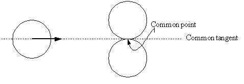

Two identical billiard balls are at rest on a frictionless, level surface, touching each other at one common point. A third, identical ball, the cue ball, is approaching along the common tangent with a constant speed of 20m/s. Assuming a completely elastic collision, with no spin on any balls, and making(reasonable) assumptions about symetry, calculate the velocity of the cue ball after the collision. The graph is as shown below
(the masses of the 3 balls are the same, but the value is unknown)
o------->8
20m/s

In the instant that all three balls are touching, their centers form an equilateral triangle. In what direction will the impulses delivered to each stationary ball by the cue ball be delivered?
Why is it that common tangent the cue ball is approaching along? I envisaged the cue ball approaching roughly parallel to the two stationary balls, off-set by half a radius?
I see it thus:

Conservation of momentum in the horizontal direction, conservation of energy overall. You should be able to deduce the angle at which the balls depart the collision.
