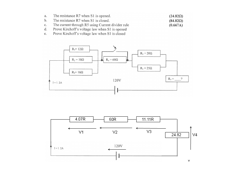

Rparellel=1/R1+1/R2...
IR1=R2/R1+R2 x I

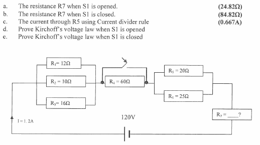

I am unsure of how to answer d) and e) using KVL because I count 4 junctions?
Where should I start?
Check your first equation ! It's not for Rpalrallel but for 1/=Rpalrallel !
And the 20 and 25 Ohm resistors are NOT parallel to e.g. the 12 Ohm !
Yes sorry that was a typo.
The total resistance for the parallel resistors still equals 15.18ohms but yes I should have done them separately:
(1/12+1/10+1/16)^-1 = 4.07ohms
(1/20+1/25)^-1= 11.11ohms
Do my values look correct?
I only know $${1\over 12} + {1\over 10}+ {1\over 16}+ {1\over 20}+ {1\over 25} \ne 15.82$$
Your values in brackets are probably the book answers ?
(1/12+1/10+1/16+1/20+1/25)^-1=15.18 ohms
Yes values are answers in the book
Then why ask if the values are correct ?
No. $${1\over 12} + {1\over 10}+ {1\over 16}+ {1\over 20}+ {1\over 25} = {1\over 2.98}$$However,$$
{1\over {1\over 12} + {1\over 10}+ {1\over 16} } + {1 \over {1\over 20}+ {1\over 25} } = 4.07 + 11.11 = 15.18$$
DevonZA said:
[ ATTACH=full]99511[/ATTACH]
What sort of device is R7 that its resistance changes depending on whether the switch is opened or closed
The parts d and e are a bit weird, because basically you use KVL to calculate R7 in a and b.
And it wouldn't be proof, just showing.
I should think they want you to show that 1.2 A * (4.07 + 60 + 11.11 + 24.82) Ohm = 120 V

With reference to the equivalent circuit below... KVL says that going around a loop the voltages sum to zero.
If I arbitrarily choose to start at the -ve terminal of the battery and go around clockwise we have to prove that..
+120 + (-V1) + (-V2) + (-V3) + (-V4) = 0
V1 = 1.2 * 4.07 = 4.884V
V2 = 1.2 * 60 = 72V
V3 = 1.2 * 11.11 = 13.332V
V4 = 1.2 * 24.82 = 29.784V
Substitute..
+120 - 4.884 - 72 -13.332 - 29.784 = 0
