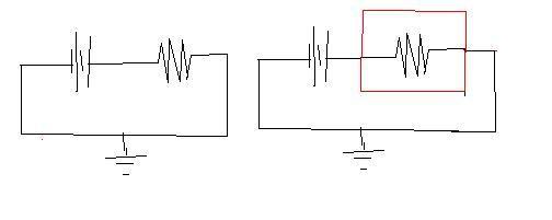

One thing I was wondering though is when you have a circuit with 10 amps running through it you add 2 shorts to make a parallel circuit. Will the current on the main wire still be 10 amps while the two parallel wires in the middle have 5 amps or would the whole circuit become 5 amps?
If you provide an alternate path for the current, with a very small resistance (basically just that of the wire), almost all of the current will flow through this (less resistive) path. (of course this is relative to the resistance of the load that the 10Amps is flowing through, but assuming this is much higher than the wire)
If the battery is happy to provide such power, the current through the short circuits will be very high (V=IR, if we short circuit the battery, R is very low (just a wire) and the current I will be high in an attempt to uphold the difference in potential across the battery).
Such large currents can damage your battery or cause explosions (or so is commonly taught)
I've attached a picture of what I believe you are trying to say here, where the two red wires are the two shorts you mention.
I don't understand this...two shorts? Anyway, if you add more branches, the current is being divided up more ways, so it stands to reason that the current in any given branch is lower..
