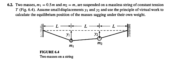

Derive the equation of motion for the system in figure 6.4 using Lagrange's equations
[/B]
Diagram of two masses on a string fixed at both ends, with segments of length L, displacements y1 and y2 downward at masses m1 and m2 respectively. Caption: FIGURE 6.4 Two masses on a string.
m1=.5m
m2=m
strings are massless and in constant tension
Lagrange=T-V
I currently have the kinetic energy as .5m1y'12 + .5m2y'22
I am confused regarding the potential energy of the system. I understand each mass will have an m*g*y component associated with them but i am unsure how the tension plays into the potential energy. Once i have the potential energy for the system i can take it from there. Any advice would be greatly appreciated, thanks!

Hmm interesting video but I am afraid something is just not clicking for me with regards to this problem.
for the potential energy there will be a m1gy1 term and a m2gy2 term. I assume there must also be terms for the work done by the tension in the strings, but only the y components as these are only given one DOF each. That would give a Ty1sin(θ1) and Ty2sin(θ3) correct? assuming θ1 is the angle between the left wall and that string and θ3 is the angle between the right wall and the attached string.
My confusion is coming when i need to take into account the string attaching the two masses. Is my logic correct thus far?

Hmm not sure that helps me a ton unfortunately.. i am reallly struggling to wrap my head around this potential energy problem.
