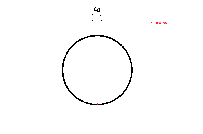

Thanks for the awesome answer. Cleared up some things. I just don't understand the energy part still. Are you sure that energy is conserved and it is not just some other constant of motion which is not the total energy? - I mean the hamiltonian can be conserved even though it's not the total energy.
Let me redo my argument that energy shouldn't be conserved. Imagine the mass starts at the bottom and rolls op due to some kinetic energy leftover. When the mass is at the bottom the rotation from the motor means nothing since the bottom is standing still - if the rotation is around the axis as drawn on the picture.
Now the ball moves up. To maintain the same angular velocity the motor must simply be doing some work on the ball for now the ball is a part of the rotating part of the hoop.
  • Diagram of a vertical circular hoop with a dashed vertical axis through its centre, a small red dot marking a point mass at the bottom of the hoop, and a legend reading mass next to a red dot.

I think I was a bit sloppy last night, and yeah, you're quite right. When L is independent, then you have a conserved quantity. Goldstein calls this the energy function h, and when you go to the Hamiltonian formulation it's just the Hamiltonian H. Like you say, however, this is not necessarily the total energy of the mass on the hoop. This time it isn't, and energy enters or leaves the system to keep the constant angular velcity.
