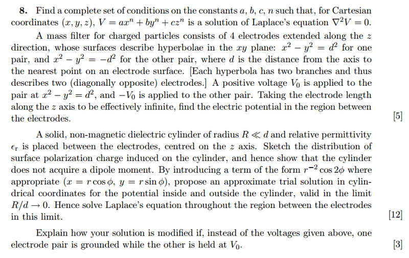

Part(a): State condition for laplace's to work. Find potential in space between electrodes.
Part (b): Find potential inside cylinder and outside.
Part (c): How would the answer change is one pair is kept at potential 0 while other V0?

For part (a), you want to find conditions on ##a, b, c## and ##n## such that ##V = ax^n + by^n + cz^n =0## [Edit: the = 0 should not be here] is a solution to Laplace's equation in general. For this part, I don't think you are meant to assume anything about the presence of electrodes or the behavior at infinity.

Right. So let's summarize the answer to the first question. ##V = ax^n+by^n+cz^n## is a solution to Laplace's equation for n = 1 and n= 2 without any restriction on a, b, c; while n = 2 yields a solution as long as a + b + c = 0.
Now we can move onto the next paragraph of the question and introduce the electrodes. You want to find the solution of Laplace's equation that satisfies the boundary conditions on the surfaces of the electrodes. The cross sections of the electrodes are hyperbolas ##x^2-y^2 = \pm d^2##. Since the electrodes extend from -∞ to ∞ in the z direction, we should be able find a solution where V does not depend on z. To fit the electrodes, it might be worth trying to find a solution V which is also quadratic in x and y.
So, from the results of your previous post, how would you choose V such that it is quadratic in x and y, does not depend on z, satisfies Laplace's equation everywhere in the space between the electrodes, and also satisfies the boundary conditions on the electrodes?
