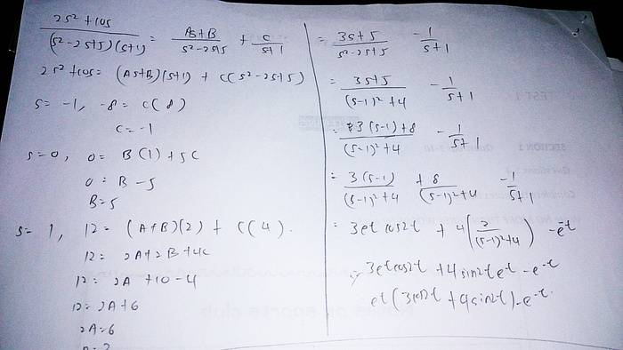

(2s^2) +10s / (s^2 -2s +5 )(s+1) , I have checked the partial fraction , it's correct , but according to the ans it's (e^t)[(3cos2t + 2.5sin2t)] - (e^-t), but my ans is (e^t)[(3cos2t + 4sin2t)] - (e^-t)

You typed
[tex]2s^2 +\frac{10s}{(s^2 -2s +5 )(s+1)}[/tex]
If you mean
[tex]\frac{2s^2 + 10s}{(s^2-2s+5)(s+1)},[/tex]
you must either use LaTeX (as I did just now) or else use parentheses, like this:
(2s^2+ 10s)/[(s^2-2s+5)(s+1)]
Anyway, that form gives an inverse Laplace that agrees with your answer.

Sorry, I mean the second one. You mean my answer is correct??
Isn't that what I said?
