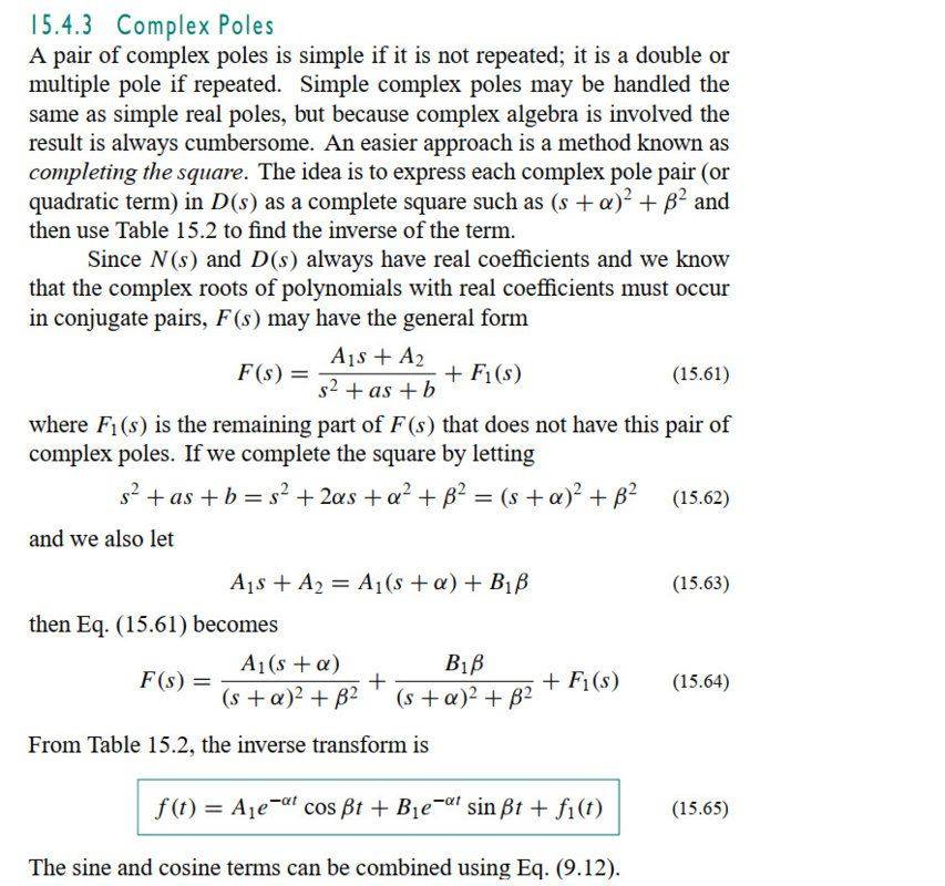

Now finding the inverse Laplace transform.
Method 1:
https://www.physicsforums.com/attac...261154/?hash=ab39a4f0474f3384a6a5c37cdc441e05

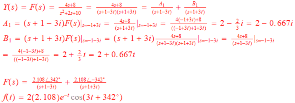

Method 2:
This method I found from this video.
Question:

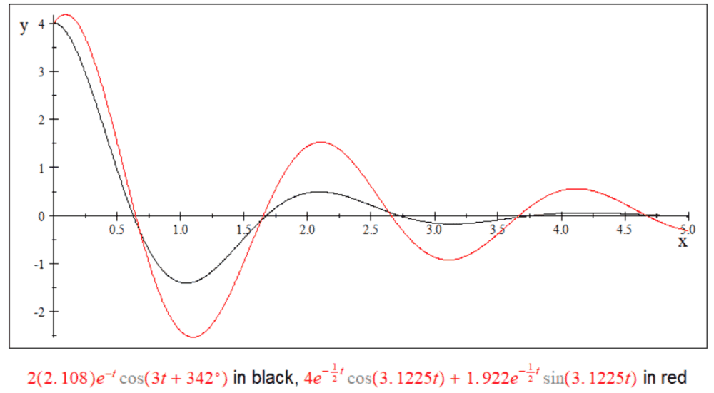

You can see that I'm getting different functions, f(t), for the mentioned methods. Where am I going wrong? Which f(t) is correct? Thank you for the help.

In your first attempt, you complete the square incorrectly: ##s^2+2s+10 = (s+1)^2+9##.

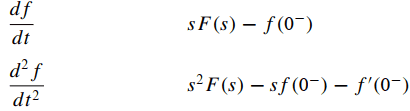

Mark44 said:
For a 2nd-order DE, you need two initial conditions, typically f(0) and f'(0).
This formula from above isn't correct:
Thank you. Yes, sorry, I didn't realize it at that time.
The previous problem was done using y′′(t)+2y′(t)+10y(t)=10 with with intial condition y(0⁻)=0. If y(t) represents displacement then its first derivative would be velocity function, v(t). As an initial condition it is assumed that y'(0⁻)=v(0⁻)=0. Now we have two initial conditions, i.e. two pieces of information about the system just a moment before it's analytically observed.

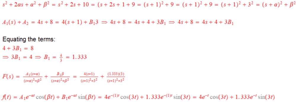

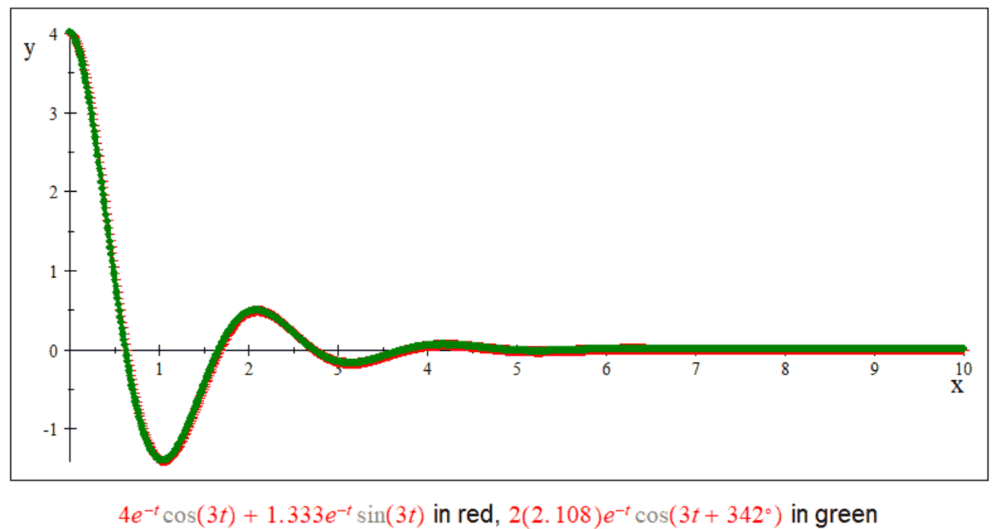

I have corrected Method 1 below. Now the results from both Methods agree. But I have a related question which is below the plot.
Question:
Apparently I completed the square wrongly but overall my completed square agrees with the original expression s²+2s+10. So, does completing a square method require that no fractions or decimals should be used, or what else is wrong with my method? Please guide me.
s²+2αs+α²+β²=s²+2s+10=s²+2(1/2)s+(1/2)²+(3.1225)²={s+(1/2)}²+3.1225²=(s+α)²+β²
Without assuming what the answer is, try simplifying that expression. I guarantee you do not get what you started with.
Let's try it: s²+2(1/2)s+(1/2)²+(3.1225)² =s²+(2/2)s+(1/4)+9.750=s²+s+0.25+9.750=s²+s+10
original expression: s²+2s+10
s²+2s+10 ≠ s²+s+10
Sorry! :sorry:
