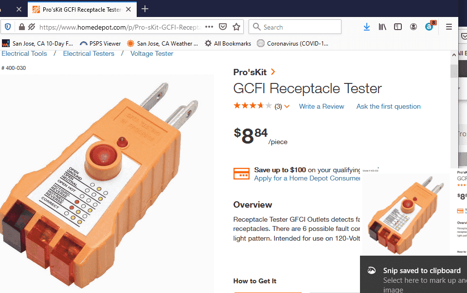

Okay, that's even weirder. If it's plugged into an outdoor GFCI outlet, the GFCI should trip before you feel much of a tingle/shock. In addition to checking things with your DVM, do you have one of these with the GFCI test button? Maybe worth the investment...
Yeah. It's with the multimeter. :sorry:

If it happened to me, I would use my GFCI device at the outside receptacle. It will tell you whether the receptacle is connected correctly. If it isn't, I would disconnect that outlet where it's connected to the house wiring.
One possibility is that the outdoor receptacle has the hot (black) and common (white) wires switched. Another is that the cable is connected incorrectly to the house wiring.
If neither of these turns out to be the case, I would suspect that the cable insulation is damaged, causing a short between the hot and either the common or ground. It wouldn't be difficult to check that -- get a roll of Romex of the length you need and appropriate to the amperage of the circuit -- 12AWG for a 20 A circuit, and 14AWG for a 15 A circuit. Disconnect both ends of the potentially damaged wire, but attach the new wire to one end, wrapping the connection with electrician's tape. As you pull the old wire out, you will be pulling new wire into replace it. If the old cable is damaged, you might be able to find a worn spot on the outer insulation or a place where it was pinched.

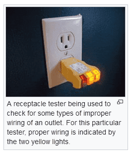

Is the power cord 3-prong or 2-prong? Have you used an electrical tester on the outlet? Are you grounded or floating when this happens (electrically, I mean).
https://en.wikipedia.org/wiki/Electrical_outlet_tester

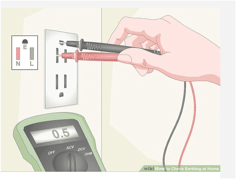

I don't have an electrical tester, but I just tested the outlet using my multimeter. According to this WikiHow article, if (Potential difference b/w live and earth) - (Potential difference b/w live and neutral) + (Potential difference b/w neutral and earth) > 2 V, the earthing might be faulty. My readings are as follows:
  • PD b/w live and Earth = 172.5 V
  • PD b/w live and neutral = 218.0 V
  • PD b/w neutral and Earth = 44.5 V
The result is -1. So, the outlet earthing is fine?

Yikes! In the US, this would be a red flag, since Neutral and Earth are tied at the house breaker panel. Are they not tied in your country? See the expected low reading from the Wikihow article that you linked to:
