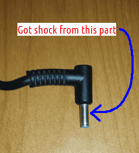

Also, I wanted to mention that yesterday I got a good shock by touching the negative pin of the laptop charger's DC jack. I have touched that terminal thousands of time in the past without any problem. But yesterday, don't know what happened. Maybe the potential difference between Earth and neutral caused that shock? Not sure. I've got a black mark on my finger.
I will have to call a certified electrician to fix the earthing, but, as almost everyone knows, the second wave of the pandemic has hit us hard, and I don't want to call anyone unless absolutely necessary because these people are just not following any COVID-19 protocols.
With the charger unplugged from the wall, what do you get for the resistance from each of the 3 pins of the plug to the outer and inner barrels of that charger?

Wrichik Basu said:
~45V between Earth and neutral lines means a faulty earthing connection.
No, ~45V between Earth and neutral means a faulty or overloaded neutral path anywhere in the system.
This is exceedingly dangerous: you must get this fixed immediately. Ideally, in order to protect against this you should install a Residual Current Device(s): in fact Wikipedia suggests that in India you should already have this. Clearly if you do then it is not working properly (it should trip when any current over a tiny threshold which is not enough to burn you flows to Earth except via the Neutral wire).
Do not confuse earthing (i.e. connection to Earth of the Earth wire - this is not what is wrong) with grounding or bonding of the Neutral return path).

Wrichik Basu said:
I found something very interesting: We have one air conditioner of 1.5 ton in our house. When the above readings were taken, it was switched on. Later, after switching it off, I tested again, and the voltage b/w Earth and neutral became 23 V. Still much higher than normal, but lesser than the previous reading. When I switched on the AC again, the value climbed up to ≈ 44 V. I chose four different outlets in the house; same observation in each of them. Any idea why this fluctuation is occurring?
Yes, the neutral return path is faulty or underrated. As you have discovered, 45V is sufficient to cause a nasty shock: if the current passes through the chest it could cause cardiac arrest. Depending on the cause, this could also cause a fire.
The cause could be a connection that has become unreliable, a new load that has been attached or a fault in your ACU. If your neutral bonding is shared with another home or homes (illegal in many areas) the fault may be nothing to do with you, but it is you that it could kill.
My multimeter shows 0.L when the two leads are separated, so that means open circuit, or infinite resistance. Keeping that in mind,
Terminal 1 (in plug)​
Terminal 2 (barrel in DC jack)​
Value (in Ω)​
Live​
Outer​
Neutral​
Outer​
Earth​
Outer​
1.011k​
