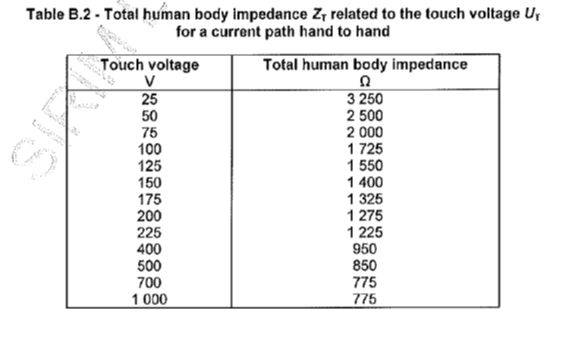

For above 1 kV substation IEEE 80 considered an average body resistance but BS EN 50522 states a relation between touch voltage and body impedance:
IEEE 80/2013 IEEE Guide for Safety in AC Substation Grounding
7.1 Resistance of the human body
For dc and 50 Hz or 60 Hz ac currents, the human body can be approximated by a resistance. The current path typically considered is from one hand to both feet, or from one foot to the other one. The internal resistance of the body is approximately 300 Ω, whereas values of body resistance including skin range from 500 Ω to 3000 Ω, as suggested in Daziel [B27], Geddes and Baker [B75], Gieiges [B76], Kiselev [B97], and Osypka [B121]. The human body resistance is decreased by damage or puncture of the skin at the point of contact.
A value of 1000 Ω in Equation (10), which represents the resistance of a human body from hand-to-feet and also from hand-to-hand, or from one foot to the other foot, will be used throughout this guide.
BS EN 50522/2012 Earthing of power installations exceeding 1 kV a.c.
